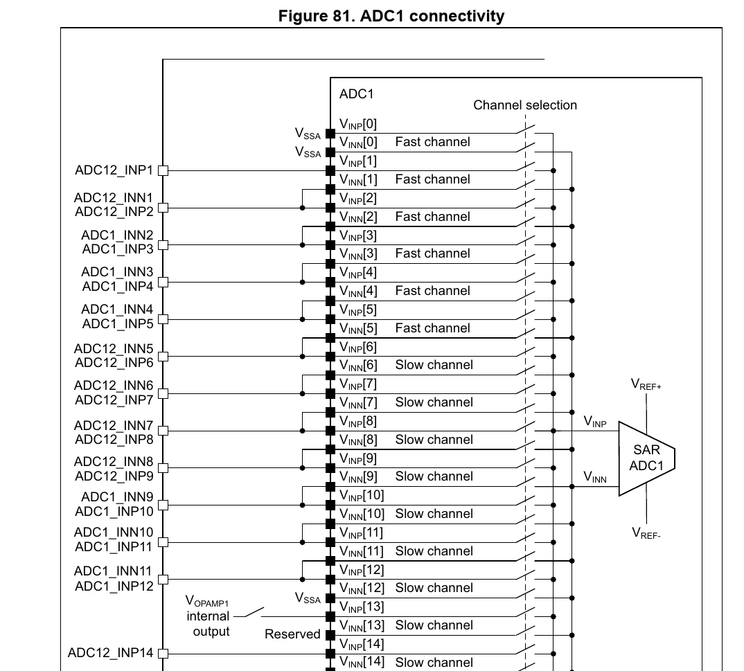

STM32G4 ADC Different Pin
STer:
      Using the ADC's Differential Function,But I can't find  ADC12_INN1  ADC12_INP1  match PIN ?

Better look at the rm -> ADC1/2/3/4/5 connectivity , to see whats possible for ADCx :
And when you set the channel in Cube, it anyway shows you, whats possible and on which pin you get the input.

If you set IN1 -> differential, IN1 + IN2 are now _INP1 + _INN1 : (IN2 cannot use separate then)
+ on pins of IN1 + IN2 then:

May I take  ADC1_INx---INP   and ADC1_IN(x+1) --- INN?
AScha.3
AScha.3Best answer
Feb 5, 2024 6:44 AM UTC
