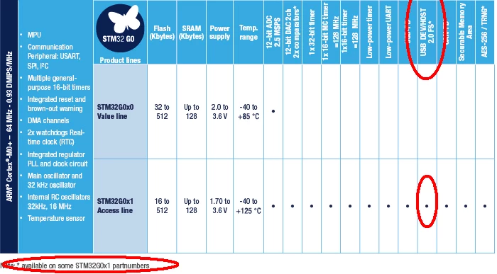

https://www.st.com/en/microcontrollers/stm32g0-series.html?icmp=tt9016_gl_****_dec2018&querycriteria=productId=SS1960 :
but on https://www.st.com/content/st_com/en/products/microcontrollers/stm32-32-bit-arm-cortex-mcus/stm32-mainstream-mcus/stm32g0-series/stm32g0x1.html?querycriteria=productId=LN2048 there is no mention of USB HOST/DEV, not even in the future products.
Is this some oversight, or are 'G0x3 with USB planned?
PS. Can that picture on website be provided in higher resolution, please?
Best answer by Imen.D
USB HOST/DEV is not supported yet, but the part number supporting it will arrive rapidly.

The G0 series looks like an overhaul of F0. STM32F071 also has no USB, only F072 has. Hopefully a G072 is planned. I Expect the mention of USB on G071 is an error.

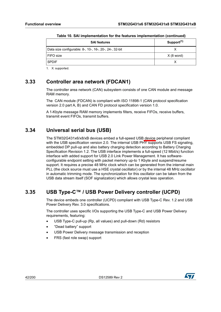

​Hello
please have a look on the STM32G4 datasheet . It has both USB 2.0 FS data interface and USB PD.
BR, JP
JDUMA
November 15, 2019
here an extract of the STM32G431x Datasheet. BR, JP​

@JDUMA​ ,
I am not talking about PD, it's completely separate from the USB data transfer.
What I am talking about is the USB "data" module. In G4, it is Device only:
but look at the initial post here, it says DEV/HOST, indicating, that G0 might have a USB module capable of being either USB Device or USB Host.
Is this the case, or is that picture a blunder?
JDUMA
November 15, 2019
​Yes that's correct (as this is shown in the portfolio overview), new STM32G0Cx are planned by next year with a USB device / host comm interface. Switching from device to host or vice versa will be possible by using "data swap" command encapsulated in the USB PD protocol. BR, JP
