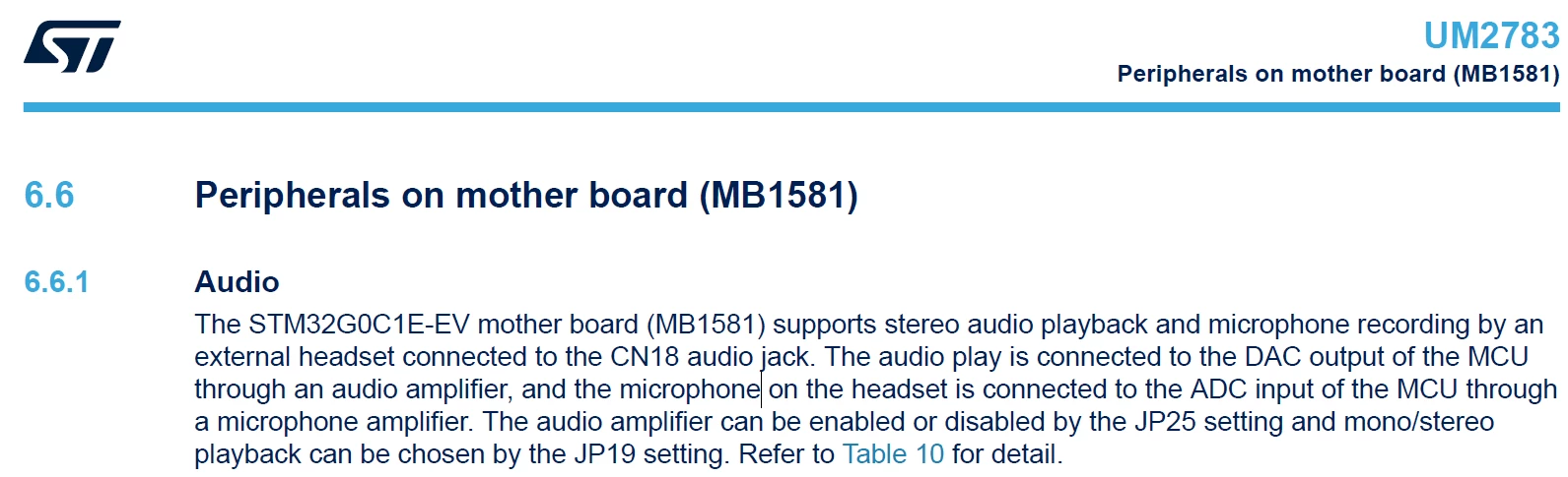

I am trying to record audio from a STM32G01CE-EV by using a microphone from a headphone connected through the jack connector. I am not able to get any proper data and I dont know if I am approaching the problem properly. How should I read the data of the microphone ( ADC, DMA, I2S)? Or if anyone knows is it possible to read the data through jack with an ADC? im not so sure anymore

> STM32G01CE-EV
You mean STM32G0C1E-EV?
I2S requires a digital signal, while ADC converts an analog signal.
A quick look at the user manual shows the microphone is directly connected to the microcontroller, so you should use the ADC to sample it.
There don't appear to be examples for the microphone on that board, but the concept is straightforward. Use the user manual to ensure the hardware connections are correct as sometimes jumpers need to move to use different board features as pins are often overprescribed.
