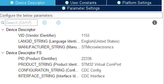

I'm try to communicate between my windows pc and my STM32GOB1RE Nucleo 64 board, with the CDC Class.
To validate my hardware ( PA11 PA12 and gnd connected to usb pc), i did few dfu flahsing operation with CubeProg without issue. Windows detect properly my device in DFU mode, i can do the programmation and new firmware runs well. -> Hardware looks fine.

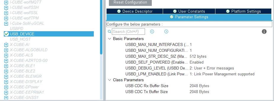

I have generated the code with CubeMX and i'm using the HSI to 60mhz. Just this simple code with USB_DRD_FS
Usb clock derived from it at 48Mhz.
I'm also using the SOF detection and CRS SYNC Source USB.
I have added th Code line in usbd_cdc_if, but it is not really the problem.
Windows generate Error of not Descriptor reading.

Here is the descriptor in usbd_desc:
We can see that bLength is 0x12 = 18.
__ALIGN_BEGIN uint8_t USBD_CDC_DeviceDesc[USB_LEN_DEV_DESC] __ALIGN_END =
 0x12, /*bLength */
 USB_DESC_TYPE_DEVICE, /*bDescriptorType*/
 0x00, /*bcdUSB */
 0x02,
 0x02, /*bDeviceClass*/
 0x02, /*bDeviceSubClass*/
 0x00, /*bDeviceProtocol*/
 USB_MAX_EP0_SIZE, /*bMaxPacketSize*/
 LOBYTE(USBD_VID), /*idVendor*/
 HIBYTE(USBD_VID), /*idVendor*/
 LOBYTE(USBD_PID), /*idProduct*/
 HIBYTE(USBD_PID), /*idProduct*/
 0x00, /*bcdDevice rel. 2.00*/
 0x02,
 USBD_IDX_MFC_STR, /*Index of manufacturer string*/
 USBD_IDX_PRODUCT_STR, /*Index of product string*/
 USBD_IDX_SERIAL_STR, /*Index of serial number string*/
 USBD_MAX_NUM_CONFIGURATION /*bNumConfigurations*/

Did you try other USB enumeration tools? Have you tried using X Nucleo shield or is it custom HW? I suggest you try with different product PID since you mentioned it get's enumerated properly as DFU.

For CRS sync to work, USB clock must be derived from HSI48, not from HSI.

Thanks every body,
I solved the issue.
I had to enable the usb interrupt.
Moreover, i had an issue in embedeed cube mx that was not updating the code when I changed the oscillator settings.
I checked the dfu bootloader application note that mentions 60mhz and interrupt.
I works now.
