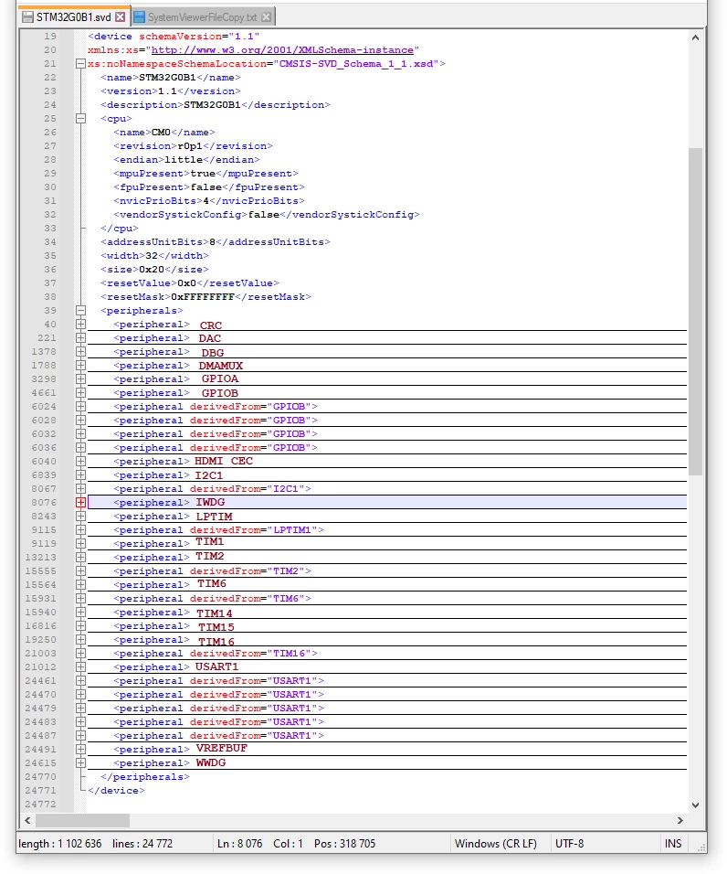

STM32G0B1 MCU, System Viewer file STM32G0B1.SVD does not contain a description of the peripheral modules ADC, COMP, EXTI, DMA, FDCAN, FLASH, RCC, SPI, USB.
0693W00000FDbJVQA1.pngSTM32G0B1 MCU, System Viewer file STM32G0xx_DFP\1.3.0\CMSIS\SVD\STM32G0B1.SVD: The file does not contain a description of the peripheral modules ADC, COMP, EXTI, DMA, FDCAN, FLASH, RCC, SPI, USB and others. There is a description of only HDMI_CEC, CRC, DAC, DBG, DMAMAX, GPIO, I2C, IWDG, LPTIM, TIM, USART, VREFBUF, WWG .

Find in https://www.st.com/resource/en/svd/stm32g0_svd.zip
New file STM32G0 System View Description 1.11 24 Aug 2021
