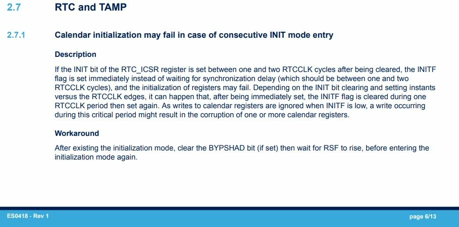

Please, answer was anyone trying to use RTC with the G071RB microcontroller? I am powerless now. The code generated by cube does not initialize RTC. I checked the entire initialization procedure if it is consistent with the documentation. Everything is correct and does not seem to be a mistake in HAL. The problem for me in the RTC_EnterInitMode function is the line SET_BIT (hrtc-> Instance-> ICSR, RTC_ICSR_INIT) ;. The INIT bit and the INITF flag are not set so that RTC does not enter the initialization mode. I am asking for an answer because the problem is not in my code only in the code generated by the cube. Is RTC initializing for you or is the problem in my microcontroller? I will add that there is no difference which source of RTC clock will be chosen.

Hello @wuio​ ,
Please have a look to the STM32G071xx Errata sheet and check if you have the same conditions as described in this device errata and your issue is related to the know limitations.
Kind Regards,
Imen

oczywiście czytałem to już i niestety u mnie bit RSF ciągle jest w stanie niskim podobnie jak bit BYPSHAD. Mam jeszcze jedeną dziwną rzecz a mianowicie pomimo braku włączonego wyjścia sygnały zegarowego na pin PA2 ten sygnał ciągle się tam znajduje. Po wyłączeniu w Cube funkcji LSCO na pinie PA2 znajduje sie 32kHz. Dopiero ustawienie tego pinu jako wyjście powoduje zniknięcie tego sygnału. Nawet użycie go jako SPI1_MOSI nic nie zmienia. Co bardzo dziwne. Czy słyszała Pani o takim przypadku?
wuio
wuioAuthor
Mar 6, 2019 3:06 PM UTC
Of course, I have read this already and unfortunately in my case the RSF bit is still in a low state, similar to the BYPSHAD bit. I have one more strange thing: in spite of the lack of the clock signal output on PA2 pin, this signal is still there. After turning off the LSCO function in the Cube, the PA2 pin has 32kHz. Only setting this pin as an output causes the disappearance of this signal. Even using it as SPI1_MOSI does not change anything. Which is very strange. Have you heard of such a case?
