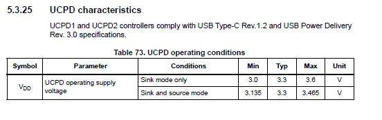

Jul 23, 2019 8:21 AM UTC
Hi John
About the question 2, you must take care about the operating condition (see chapter 5.3.23 of the STM32G071CB datasheet)
BR
Dominique
JChau
JChauAuthor
Jul 23, 2019 9:49 AM UTC
Hi Dominque
Yes I do take notice and asked our hardware guy to bridge the mcu to 3.3V, because we already noticed another problem that not even GoodCRC is sent from any device, so we checked hardware and the upper bound voltage of CC line is only 0.74V, much lower than requried 1.04-1.2V per PD specification.
Anyway, I can confirm that raising the voltage of VDD to 3.3V solved my question 2, but we still don't get any GoodCRC just for your interest :(
Thank you very much for your help anyway!

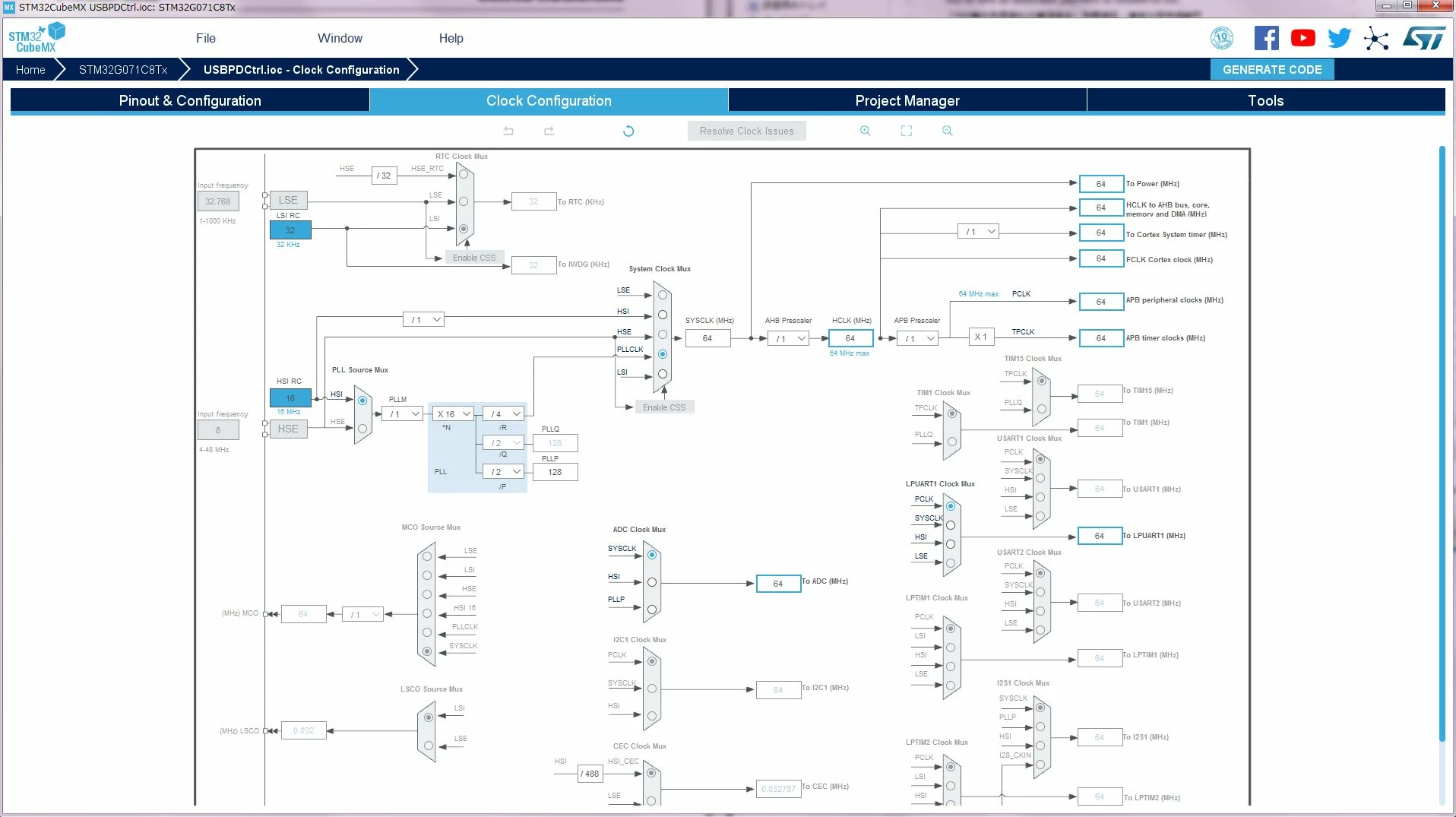

Dominique
Jul 23, 2019 12:02 PM UTC
Hi John,
This issue could be link with the system clock please could you share the sytem clock configuration ? to make working UCPD, HSI clock shall be enabled.
To check if the problem is linked with the system clock please could use the settings from our G0 demo
BR
Dominique
JChau
JChauAuthor
Jul 23, 2019 12:23 PM UTC
Hi Dominque,
Attached is the settings from STM32CubeMX, from what I can see it should be the same as G0 demo except PLLN/PLLR, but final clocks are the same

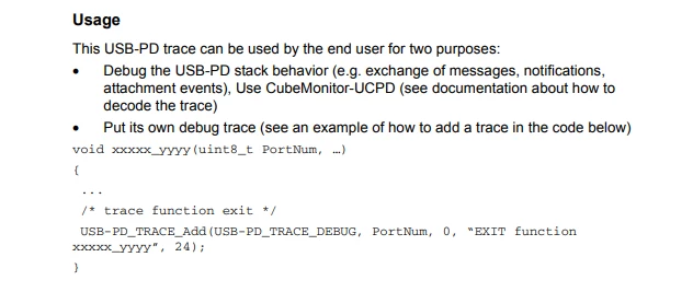

Jul 25, 2019 8:36 AM UTC
Hi John,
Yes our system allows to add your own debugging trace, please see below an extract from the user manual
BR

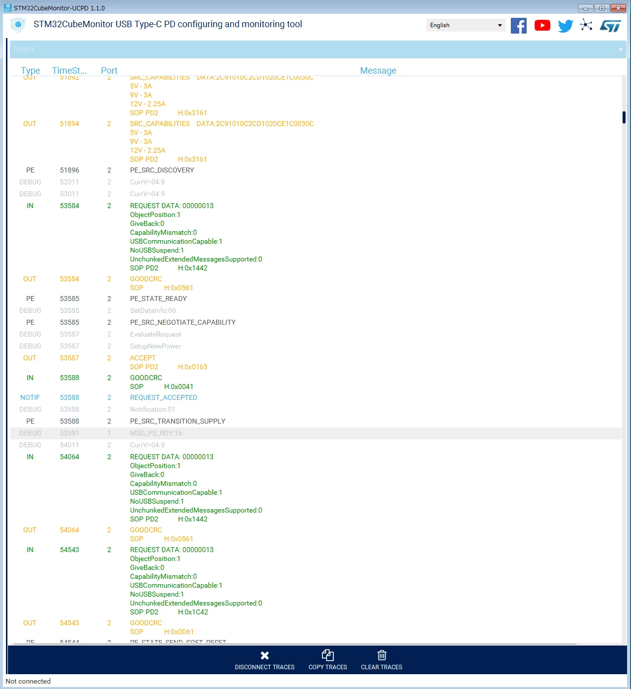

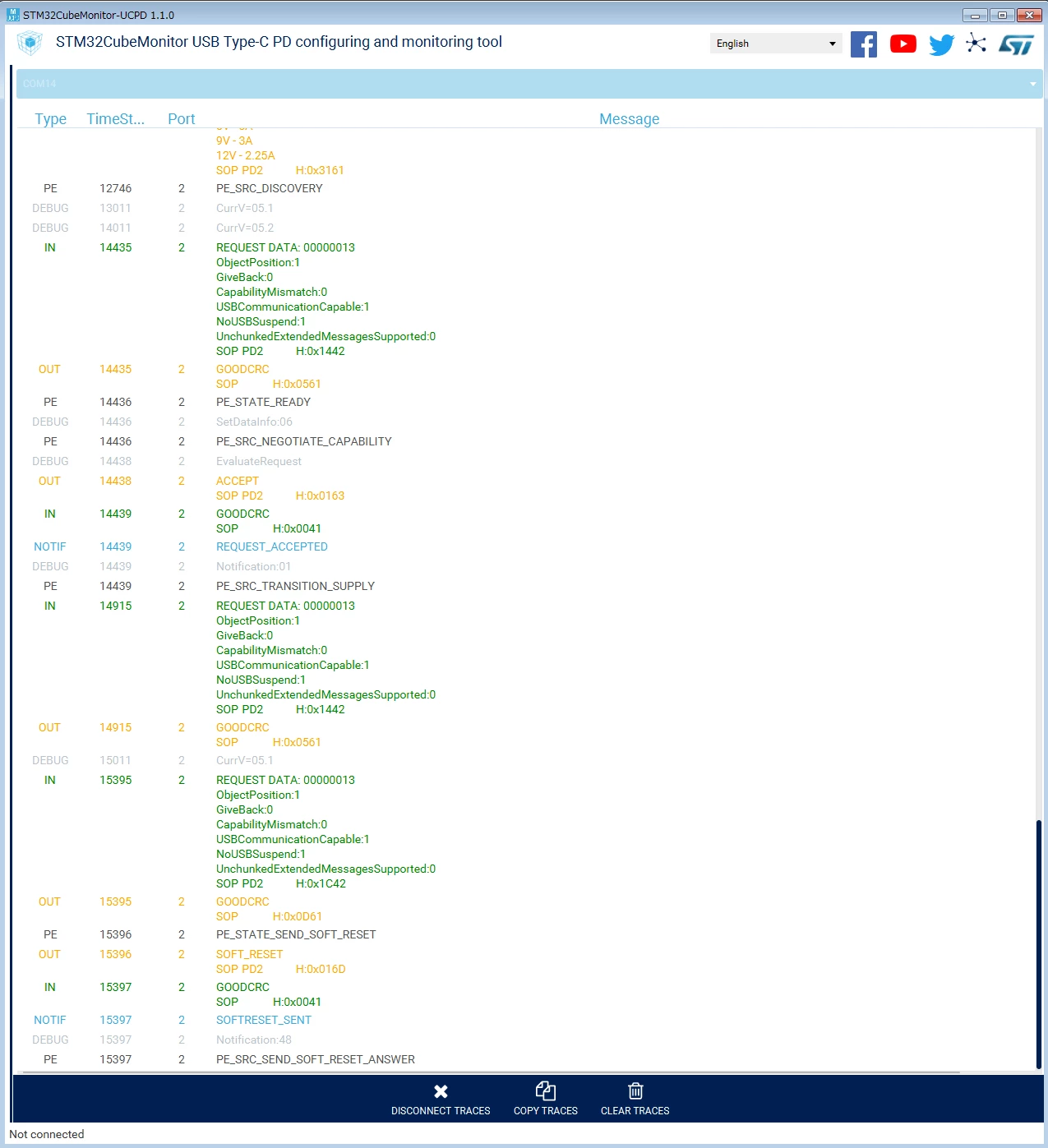

Jul 25, 2019 9:57 AM UTC
Hi Dominique,
Please find attached screen capture of USB-PD trace,
I now solved most of the problem and communication with device seems goes smooth, however after device sent a request, from your manual UM2552 USBPD_PE_RequestSetupNewPower should have been called after PE_SRC_TRANSITION_SUPPLY, and I have a debug trace simply write "SetupNewPower" to ensure that function is called, but as seen from the screenshot no such thing is written and break point there is not invoking confirms that function is not called at all, I guess that's why a soft reset/request loop keeps going on without success, can you please provide me some clues why is this happening?0690X000009Z5GLQA0.png

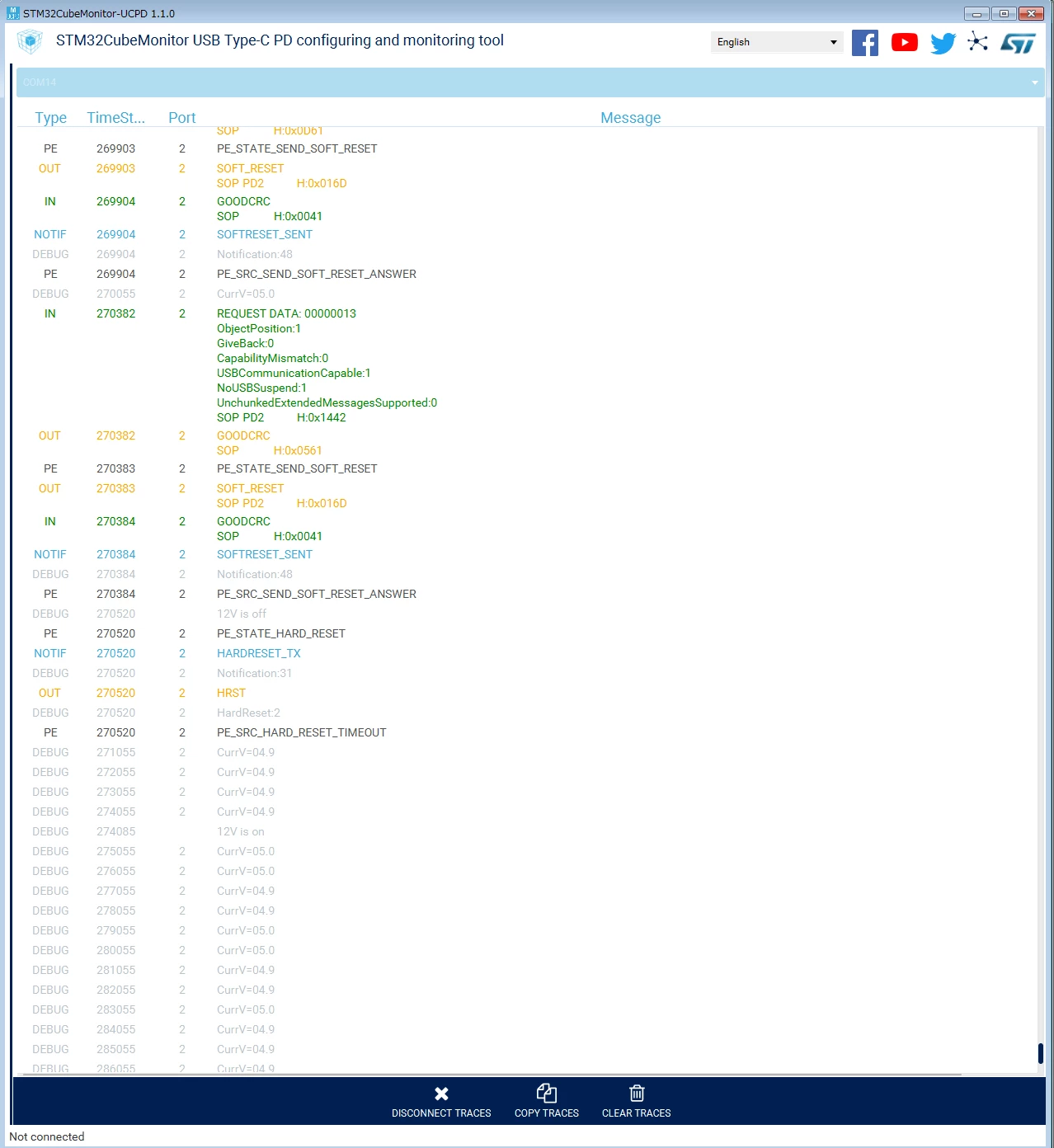

JChau
JChauAuthor
Jul 26, 2019 3:29 AM UTC
And also after my board as a source sends hardreset with USBPD_PE_Request_HardReset, no USBPD_HR_STATUS_START_REQ callback is received after PE_SRC_HARD_RESET_TIMEOUT.
And btw I tried forcing a PS_RDY signal by focing SetupNewPower after EvaluateRequest, which in turn calling USBPD_PE_Request_CtrlMessage, but returned with USBPD_FAIL.
