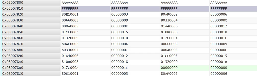

Hi, I'm trying to use https://www.st.com/en/embedded-software/x-cube-eeprom.html on my custom stm32g030 board.
Following the examples I write this code:
 HAL_FLASH_Unlock();
 ee_status = EE_Init(EE_FORCED_ERASE);
 if(ee_status != EE_OK) {
	 Error_Handler();
 VarValue = 3;
 for (Index = 1; Index < NB_OF_VARIABLES+1; Index++)
	 ee_status = EE_WriteVariable32bits(Index, Index*VarValue);
	 /* Start cleanup polling mode, if cleanup is needed */
	 if ((ee_status & EE_STATUSMASK_CLEANUP) == EE_STATUSMASK_CLEANUP) {ErasingOnGoing = 0;ee_status|= EE_CleanUp();}
	 if ((ee_status & EE_STATUSMASK_ERROR) == EE_STATUSMASK_ERROR) {Error_Handler();}
 for (uint8_t idx = 0; idx < NB_OF_VARIABLES; idx++)
	 // Virtual address arranca en 1
	 ee_status = EE_ReadVariable32bits(idx+1, &VarValue);
	 if (ee_status != EE_OK) {Error_Handler();}
 /* Lock the Flash Program Erase controller */
 HAL_FLASH_Lock();
I unlock the flash, the Init the EE emulation, write 10 variables (check if a cleanup is required), then read back the values.
This works ok. After running this code a couple of time I get:
I'm not sure why I have 4*32 bits with 0xFFFFFFFF on 0x08007810.
Then I get 16 bits VA (0001) 16 bits CRC (80E01) and 32 bits value 00000003.

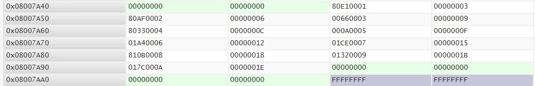

Then I want to try to read data after power off. So I comment back writing operations, flash the code and connect with STM32 Programmer to read the data. I get the following:
each time I re-connect the programmer (and so a reset is made) 2x32 bits 0's are written into the flash. It's come from ee_status = EE_Init(EE_FORCED_ERASE); calling that is forcing the write of those 0's. I've tried with EE_CONDITIONAL_ERASE but the same happens.
