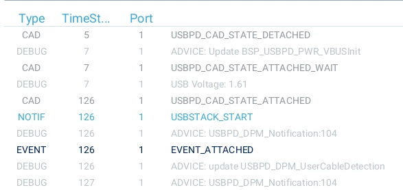

This is as far as it gets:
With a sniffer device, I can see the power supply sending source capabilities, but these packets are nowhere to be seen when logging the application.
This leads me to believe, the USB PD stack isn't getting the data.

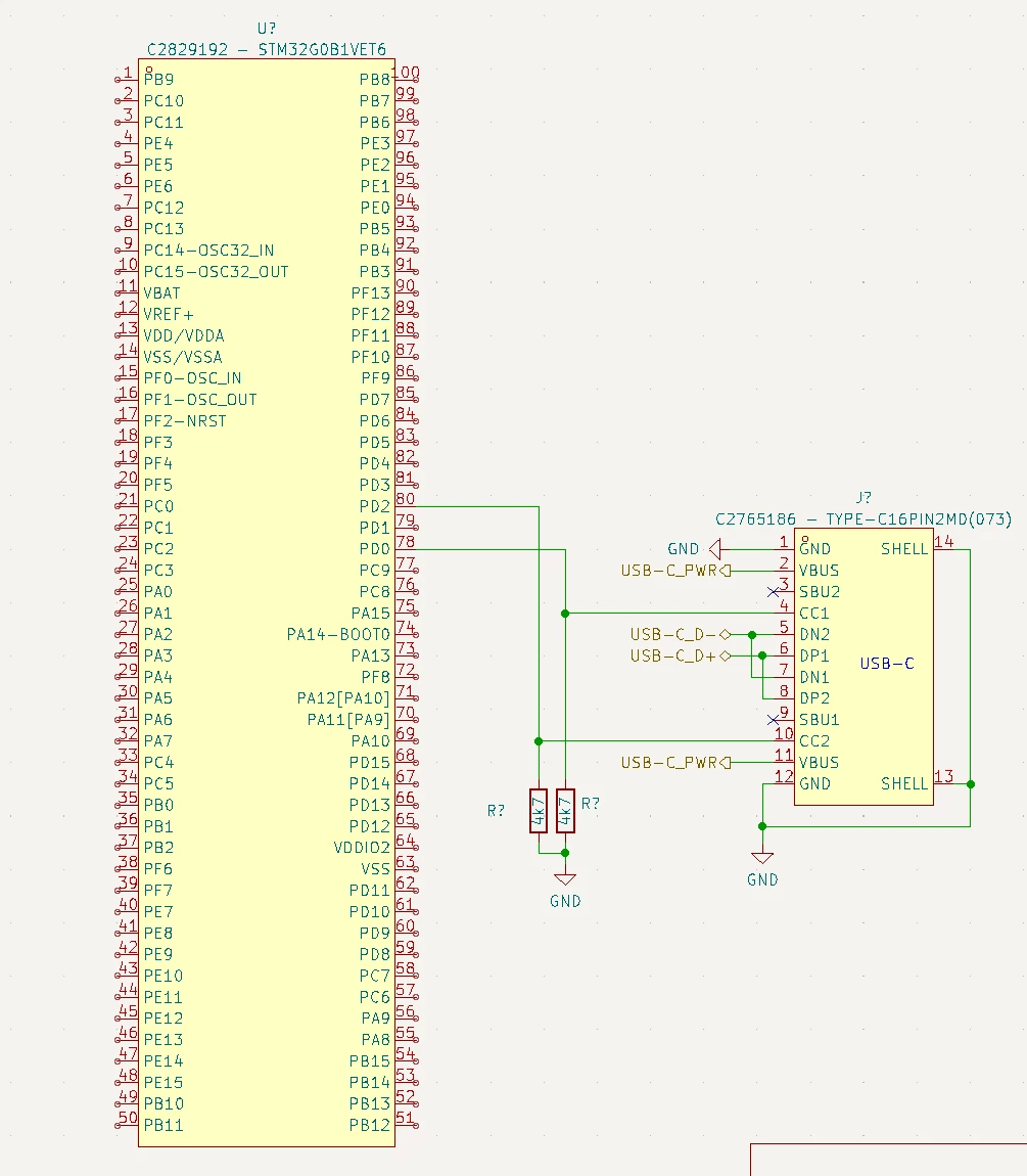

Sep 28, 2023 4:44 PM UTC
The CC1 and CC2 lines are connected like this

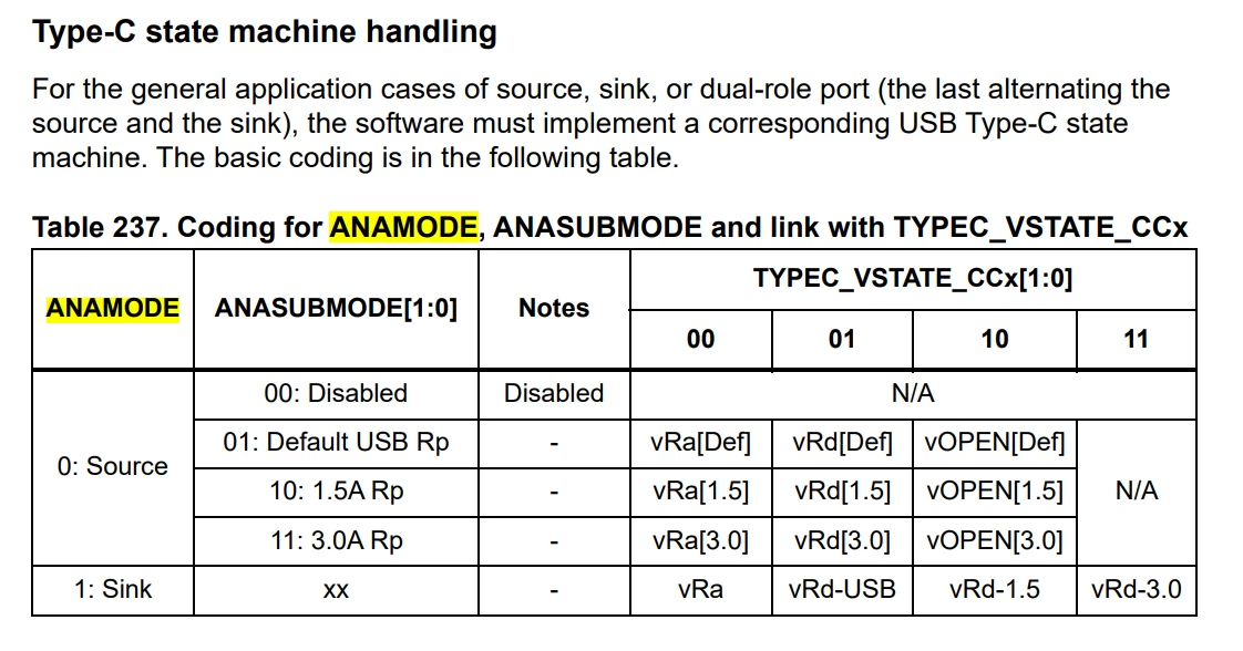

LLECH.1
Sep 29, 2023 12:19 PM UTC
Hello @Tadeas_Pilar,
As I said you don't need those two resistors, you have to remove them. UCPD IP already includes resistors that you can configure using ANAMODE and ANASUBMODE of the UCPD control register.
In your case, ANAMODE must be set to 1.

Also external pull down resistors don't actually hurt anything and can stay.
