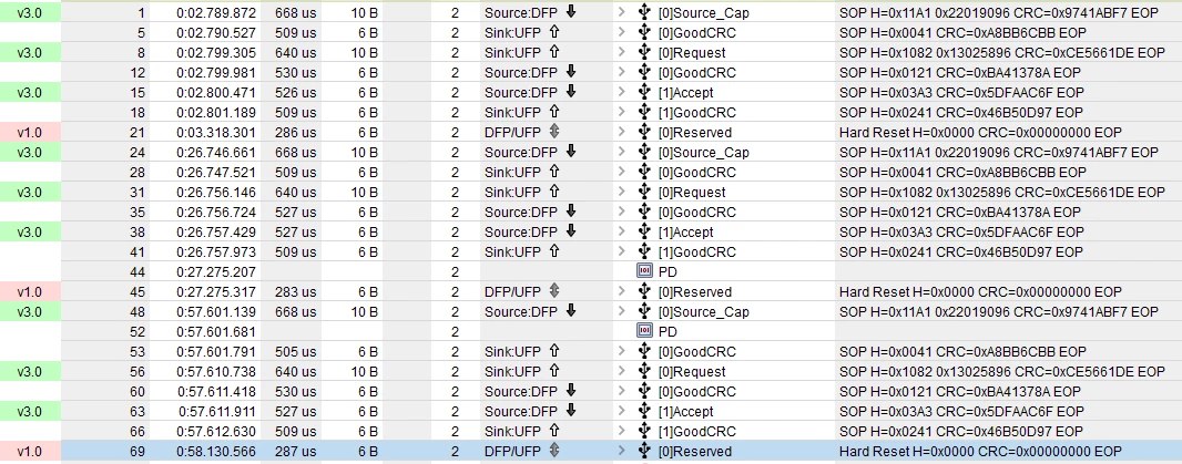

I am also getting a Hard Reset that is set in the UCPD SR (status register) (Rx Hard Reset detect interrupt), every single time during power negotation after the Source sends accept, and Sink sends a Good CRC. Hard Reset is seen, and stops the power negotation. See attached screenshot of the USB-PD negotiation from Total Phase. I am using an STM32G474RETx, with RTOS2 (RTX5). I have this working with the example using FreeRTOS, but I want to utilize RTOS2 with RTX5. Is the STM32 USBPD API compatible with RTOS2 RTX5?
Thanks,
Eric

Visitor II
Jul 13, 2023 5:19 PM UTC
Thanks for the reply Guenael. I was able to resolve my issue by adding the USBPD_DPM_TimerCounter(); function into my TIM global interrupt handler.
