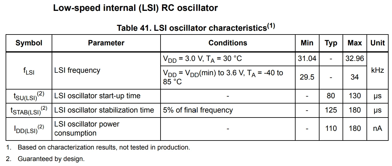

Jan 9, 2024 4:44 PM UTC
Why does the LSI have +-50% tolerance?
Jan 9, 2024 4:51 PM UTC
The LSI here does not have +/- 50% tolerance. Perhaps create a new post if you have additional questions.
To address the general question: Why is the LSI not exact? Because fabrication tolerances, specifically on oscillator circuits like this, contribute to the tolerance.

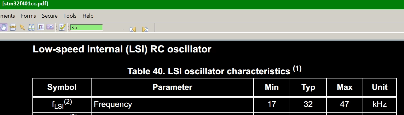

Jan 9, 2024 9:28 PM UTC
Well this one has
How come the tolerance is so much bigger on this one?

Jan 9, 2024 9:42 PM UTC
LSI is intended to run the independent watchdog, not in lockstep with the external crystal, but independent of the external crystals. The frequency is crappy and varies with temperature, but you don't need external components.
Some figure that it is a 32767 Hz source. No, it's 30kHz, or 40kHz, or 17-47kHz, depending on how the die was laid out on a day, the temperature, and phase of the moon. Don't use it where you expect a reliable, predictable frequency. If you use it as a IWDG, don't set your tolerances too tight or you will be sad.
Note: I am not a silicon layout engineer, but I did stay at a Holiday Inn once.

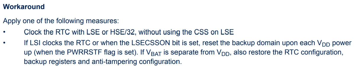

May 30, 2024 3:50 AM UTC
I am having the same problem. I am using the STM32G030K6 powered at 3v3. I use the LSI to drive the RTC and the device spends most of its time in deep sleep (STOP0) mode. I don't need great accuracy, but I expected it to meet the specs in the datasheet. Like others, I initially measured 48.93kHz at MCO. I have implemented the second workaround from errata 2.2.1: reset backup power domain on POR, and it seems to work MOST of the time, but not always.  Once in a while, the LSI is still running far above its 34kHz max and I know the POR flag was set (and so this code ran) because I display the CSR register at startup.
@TDKare you aware of a way to correct the failure condition in software if the workaround fails?  It looks like once the condition has occurred, BOTH a POR and the workaround are required to clear it; a hard reset will not clear the condition.
Code to reset backup power domain follows. I have also tried removing the PWRRSTF conditional and always running the code to reset the backup power domain at startup and can still occasionally reproduce the high (48.9kHz) LSI frequency.
 // See Errata 2.2.1: Unstable LSI after main power domain reset
 // if reset was due to POR or BOR, reset the backup power domain
 if (RCC->CSR & RCC_CSR_PWRRSTF) {
 SET_BIT(RCC->APBENR1, RCC_APBENR1_PWREN); // enable clk to power subsystem
 SET_BIT(PWR->CR1, PWR_CR1_DBP); // enable access to backup power domain
 SET_BIT(RCC->BDCR, RCC_BDCR_BDRST); // reset backup power domain
 CLEAR_BIT(RCC->BDCR, RCC_BDCR_BDRST);
 CLEAR_BIT(PWR->CR1, PWR_CR1_DBP);

May 30, 2024 11:03 AM UTC
Hi @DAlbe.3 ,
Could you please insert the following wait loops to ensure that required bits are set properly:
  • just after line 5 of your code to ensure that access to backup power domain is enabled:
 while(READ_BIT(PWR->CR1, PWR_CR1_DBP) == RESET);
  • just after "SET_BIT(RCC->BDCR, RCC_BDCR_BDRST);"
while(READ_BIT(RCC->BDCR, RCC_BDCR_BDRST) == RESET);
 Does this make a difference?
-Amel
DAlbe.3
May 30, 2024 2:26 PM UTC
Hi @Amel NASRI ,
First, many thanks for responding so quickly!
I added the checks for DBP and BDRST and it seemed better at first, but unfortunately I was still able to reproduce the bug (LSI > 48kHz).  It requires 1-25 POR to see it, but it did happen and as always, persists until the next POR. I have been able to reproduce it numerous times.
Separately, I'm interested in your suggestion regarding PWR_CR1_DBP because I enable/disable DBP in several places in my codebase and need to know if I should add this check (to wait for DBP set) before accessing registers in the backup power domain. There's no mention of it in the RM; is this a known issue with setting DBP?
The code run at startup is:
 SET_BIT(RCC->APBENR1, RCC_APBENR1_PWREN); // enable clock to pwr control subsystem
Regards,
David
