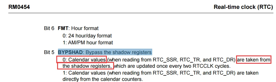

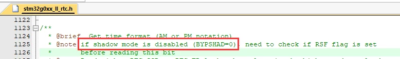

Hello @lyiku.1​,
Thanks for your post and for bringing this issue to our attention.
I have created an internal ticket in order to correct the note in the header file.
Internal ticket number: 149356 (PS: This is an internal tracking number and is not accessible or usable by customers).

Hi @lyiku.1 ,
I closed this thread as the issue is fixed in the latest release of STM32CubeG0 package.
Thank you for your contribution.
