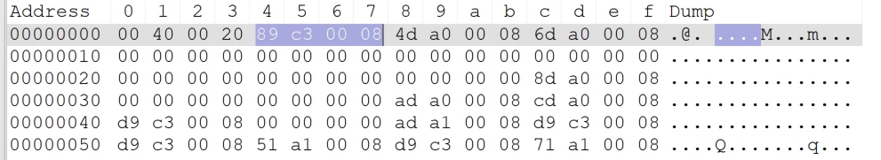

STM32G0 Crash when changing bootloader and application adress
I am trying to jump from bootloader to application at address 0x08004800 i STM32G070 but it crashes.
The same code worked fine jumping to address  0x08007000
Bootloader jump looks like this:
#define BL_FLASH_START	0x08000000
#define BL_FLASH_SIZE 0x4800 // 18 kB reserverade för BL, OBS! Startadress måste vara alignad mot 32 byte, dvs jämnt delbar med 32..
#define BL_FLASH_END (BL_FLASH_START + BL_FLASH_SIZE-4) // 4 byte checksumma
#define APP_FLASH_BANK_SIZE 0xDC00 // 55 kB / appl bank
// Defines för applikationen
#define FLASH_START (BL_FLASH_START + BL_FLASH_SIZE)
HW_WD_Trig();
JumpAddress = *(uint32_t*) (FLASH_START + 4);
Jump_To_Application = (pFunction) JumpAddress;
// disable global interrupt
__disable_irq();
/* Initialize user application's Stack Pointer */
__set_MSP(*(uint32_t*) (FLASH_START));
Jump_To_Application();

RFlod.2
RFlod.2Author
Senior
Aug 21, 2026 14:33 UTC
I also verifired that the instruction to execute after jump is  Instr: 0800C389 which same as in bin file
