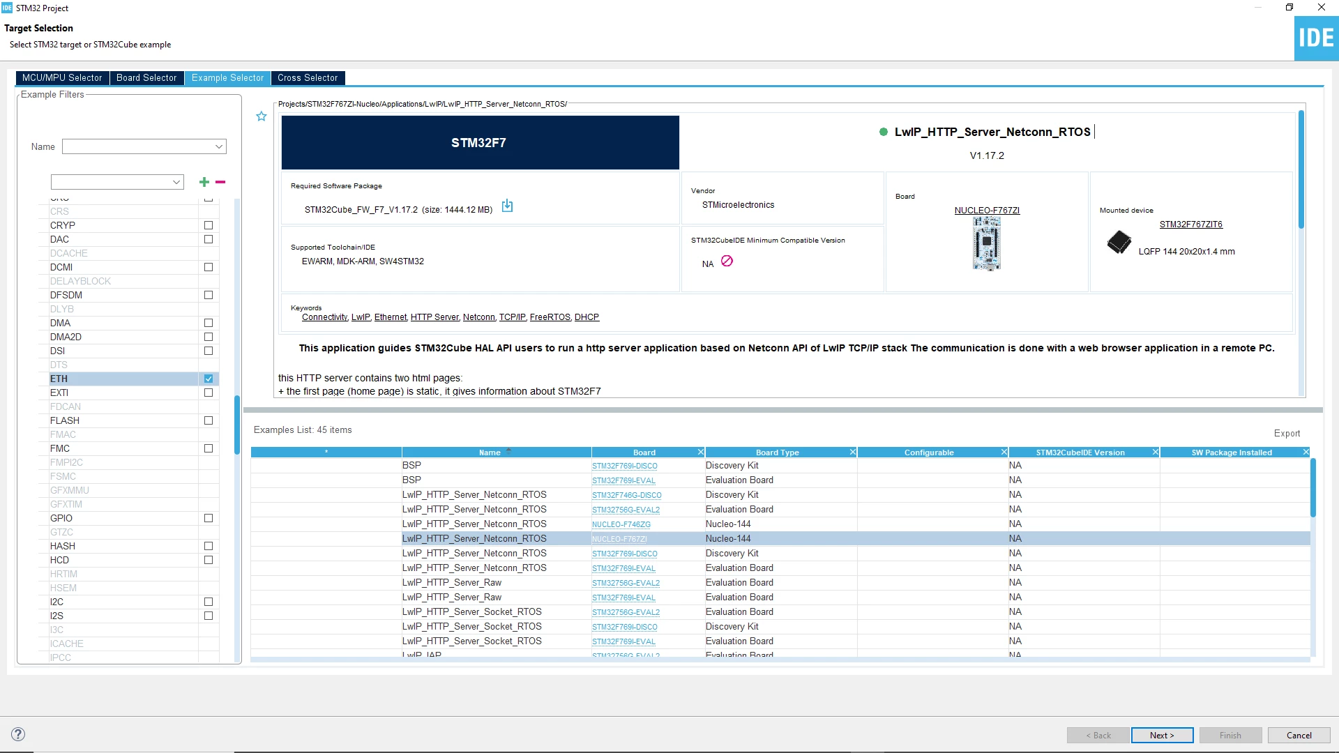

Are you forced to use F767 + FreeRTOS+LWIP ?
I do not use F7 as it is too slow to deliver good performances with ethernet.I prefer H7 family, and get more resilient applications.
On the other side, I moved all my design from FreeRTOS+LWIP to AZRTOS+NetXDuo, os is much more reliable and you can achieve reasonable performances.
All that sad, the example LwIP HTTP Server Netconn RTOS ver 1.17.2 should run out of the box - providing STM32CubeIde was set up correctly and board is good.

Hello @simenvoffa ,
You can access the application  for STM32F767ZI  board that  guides you  to run a http server application
based on Netconn API of LwIP TCP/IP stack : ( Github Link)  LwIP_HTTP_Server_Netconn_RTOS
Make sure to follow the instructions in the README file to set up your project correctly.
