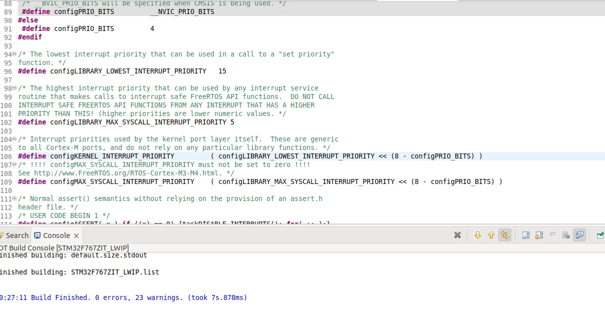

FreeRTOS has a kernel IRQ priority level. No interrupt service routine which references an RTOS API can have a higher priority. Check the FreeRTOS configuration header to see what the kernel priority level is.

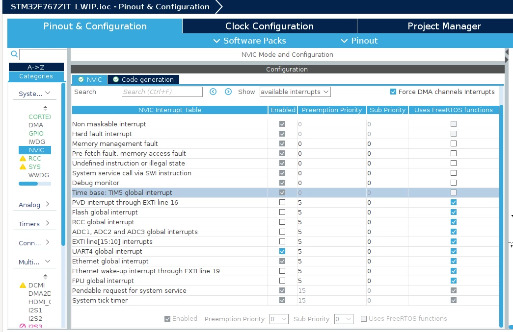

MKuhl.1Author
Oct 7, 2022 8:40 AM UTC
These are my Interrupt Configuration settings. All the Interrupt handlers seem to have the same Priority as the the configLIBRARY_MAX_SYSCALL_INTERRUPT PRIORITY. Which seem to be ok. Or am I missing something?

You were talking about TIM6 but the screenshot shows TIM 5 (at wrong prio NVIC 0) ?

It's OK for HAL timebase interrupt to be above configMAX_SYSCALL_INTERRUPT_PRIORITY. One just cannot use any FreeRTOS API in such interrupts.
