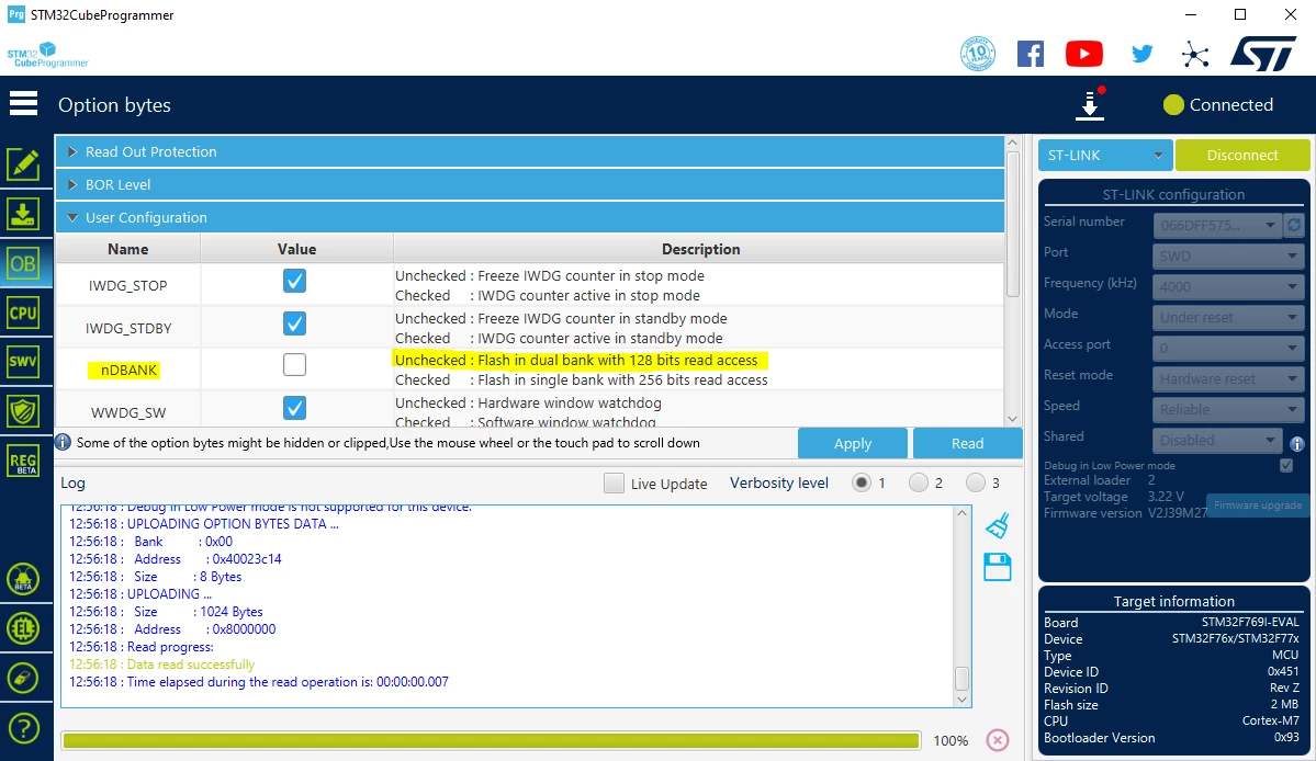

Currently my STM32F767 is coming up in dual bank mode (I'm not sure why, since this does not seem to be the default) but I want to turn this off so I get the full 2Mbytes.
However, I can see from AN4826 that if I turn off dual bank mode while the software is running, it's likely to crash because the flash width changes from 128 bit to 256 bit.
I thought there would be a way to set the bank mode in CubeIDE, but I cannot find it anywhere. If I use CubeIDE to program an image into flash, then that seems to effectively limit me to dual bank mode and only 1Mbyte of flash.
Can you advise me how I can turn off dual bank mode so that the image is programmed in by CubeIDE as a single-bank image?

To switch from dual-bank to single-bank mode ,  we recommend using STM32CubeProgrammer to modify the flash option bytes by :
1- Connect your device to your PC and open STM32CubeProgrammer.
2- Navigate to the Option Bytes tab on the left sidebar (highlighted as "OB" in the image).
3- Under User Configuration, locate the option named nDBANK.
4- You will see that:
       When unchecked, the device operates in dual bank mode with 128-bit read access.
       When checked, the device operates in single bank mode with 256-bit read access.
5- To disable dual bank mode, check the nDBANK box to enable single bank mode.
6- Click Apply to program the option bytes.
Br
Oct 6, 2025 7:25 AM UTC
Hi MOBEJ,
Many thanks for your helpful response.
I would still like a little more clarification on this. I have been using CubeIDE on its own quite happily, and I have only just downloaded CubeProgrammer as a result of this answer. How do the two work together?
I'm concerned that the nDBANK setting is only set temporarily from CubeProgrammer, and does not seem controllable from CubeIDE, so how would I ensure that the nDBANK setting I require is preserved across reboots/power downs?

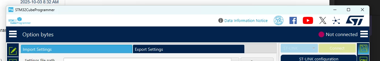

Oct 6, 2025 9:23 AM UTC
Hi MOBEJ,
Now I am having programs reconnecting using CubeProgrammer. It worked the first time I tried it, but now, I click on Connect, and it simply does not connect, even though the Connect button is faded out.
I have rebooted my laptop and the target, but this has made no difference.
Oct 6, 2025 9:32 AM UTC
In addition, the Option Bytes icon no longer displays the bars at the top (including "User Configuration").
