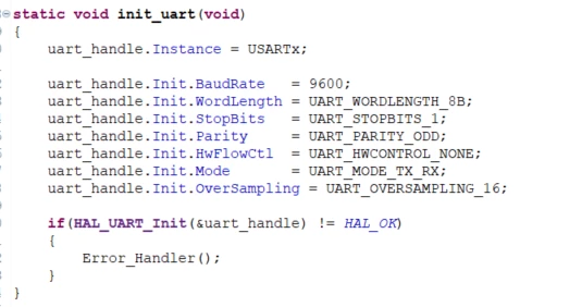

I have created my own example to print the data on HyperTerminal (putty) following the already given example "UART_Printf" but mine is only printing the first char of the data and then stuck forever.

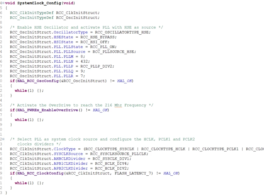

Here is the clock config code
and uart config:

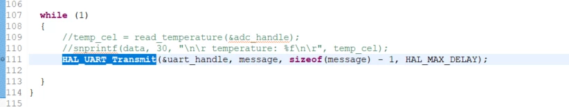

and what I would like to print:

Please use the code pasting tool, see icon </>  rather than in-lining screen shots of code
Not sure what "message" is defined at, nor how the pins are configured, etc.
The fragment shown should be workable, perhaps look elsewhere for the actual issue.

 uint8_t message[] = "UART!\r\n";
 while (1)
	 //temp_cel = read_temperature(&adc_handle);
	 //snprintf(data, 30, "\n\r temperature: %f\n\r", temp_cel);
	 HAL_UART_Transmit(&uart_handle, message, sizeof(message) - 1, HAL_MAX_DELAY);

 * The system Clock is configured as follow :
 * System Clock source = PLL (HSE)
 * SYSCLK(Hz) = 216000000
 * HCLK(Hz) = 216000000
 * AHB Prescaler = 1
 * APB1 Prescaler = 4
 * APB2 Prescaler = 2
 * HSE Frequency(Hz) = 8000000
 * PLL_M = 8
 * PLL_N = 432
 * PLL_P = 2
 * PLL_Q = 9
 * PLL_R = 7
 * VDD(V) = 3.3
 * Main regulator output voltage = Scale1 mode
 * Flash Latency(WS) = 7
 * @param None
 * @retval None
void SystemClock_Config(void)
 RCC_ClkInitTypeDef RCC_ClkInitStruct;
 RCC_OscInitTypeDef RCC_OscInitStruct;
 /* Enable HSE Oscillator and activate PLL with HSE as source */
 RCC_OscInitStruct.OscillatorType = RCC_OSCILLATORTYPE_HSE;
 RCC_OscInitStruct.HSEState = RCC_HSE_BYPASS;
 RCC_OscInitStruct.HSIState = RCC_HSI_OFF;
 RCC_OscInitStruct.PLL.PLLSource = RCC_PLLSOURCE_HSE;
 RCC_OscInitStruct.PLL.PLLM = 8;
 RCC_OscInitStruct.PLL.PLLN = 432;
 RCC_OscInitStruct.PLL.PLLP = RCC_PLLP_DIV2;
 RCC_OscInitStruct.PLL.PLLQ = 9;
 RCC_OscInitStruct.PLL.PLLR = 7;
 if(HAL_RCC_OscConfig(&RCC_OscInitStruct) != HAL_OK)
 while(1) {};
 /* Activate the OverDrive to reach the 216 Mhz Frequency */
 if(HAL_PWREx_EnableOverDrive() != HAL_OK)
 while(1) {};
 /* Select PLL as system clock source and configure the HCLK, PCLK1 and PCLK2
 clocks dividers */
 RCC_ClkInitStruct.ClockType = (RCC_CLOCKTYPE_SYSCLK | RCC_CLOCKTYPE_HCLK | RCC_CLOCKTYPE_PCLK1 | RCC_CLOCKTYPE_PCLK2);
 RCC_ClkInitStruct.APB1CLKDivider = RCC_HCLK_DIV4;
 RCC_ClkInitStruct.APB2CLKDivider = RCC_HCLK_DIV2;
 if(HAL_RCC_ClockConfig(&RCC_ClkInitStruct, FLASH_LATENCY_7) != HAL_OK)
 while(1) {};

static void init_uart(void)
	uart_handle.Instance = USARTx;
	uart_handle.Init.BaudRate = 9600;
	uart_handle.Init.WordLength = UART_WORDLENGTH_8B;
	uart_handle.Init.StopBits = UART_STOPBITS_1;
	uart_handle.Init.Parity = UART_PARITY_ODD;
	uart_handle.Init.HwFlowCtl = UART_HWCONTROL_NONE;
	uart_handle.Init.Mode = UART_MODE_TX_RX;
	uart_handle.Init.OverSampling = UART_OVERSAMPLING_16;
	if(HAL_UART_Init(&uart_handle) != HAL_OK)
		Error_Handler();

@Tesla DeLorean mpu and clock_config are same as in the "UART_Printf" example code. I following the same same example project.

Check the return value of the HAL function call.
Use the most precise clock (HSE?) at a high clock rate to generate precise timing on the serial line.
Try another cable, terminal prog (TeraTerm) and/or computer.
Step into the HAL code, it is open source and try to find out what's going on.
Check the data on the wires using a cheap logic analyzer or scope.
hth
KnarfB
KnarfB
Feb 7, 2025 5:20 PM UTC
sizeof should go to line 110, and strlen to line 111. Where & how is message defined?
