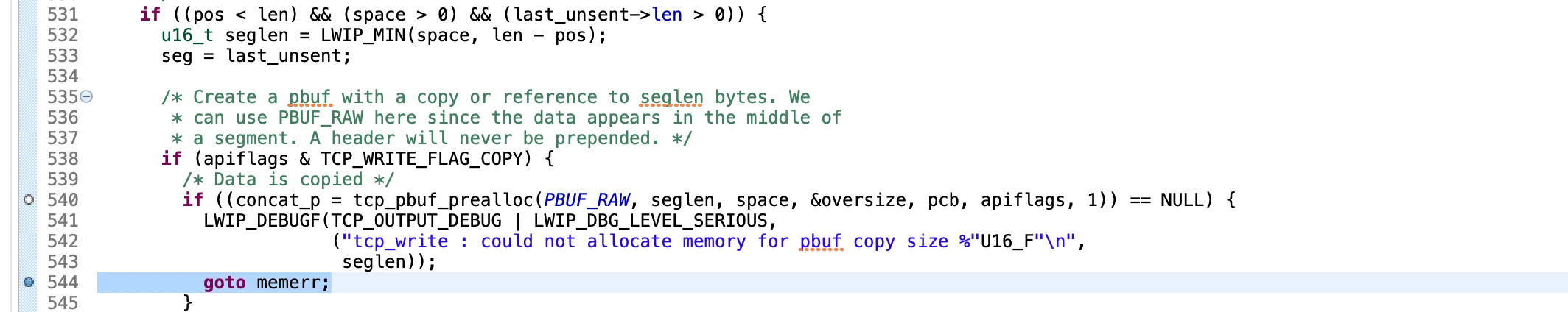

Ok understood what TX are. Do you think it is a good solution increase their number? I attached the point of tcp_write function in tcp_out.c file where I get the error
Unlikely error at that point is directly linked to available descriptors. But I'd try to let LwIP  map and queue all segments of a large TCP packet at once, so sending it can run in background.

Jul 28, 2024 3:02 PM UTC
I mean that this error does not look directly related to TX descriptors. Find why tcp_pbuf_prealloc fails. The memory area for LwIP pool in ST examples is defined in weird and dangerous way, make sure it does not conflict with other memory.

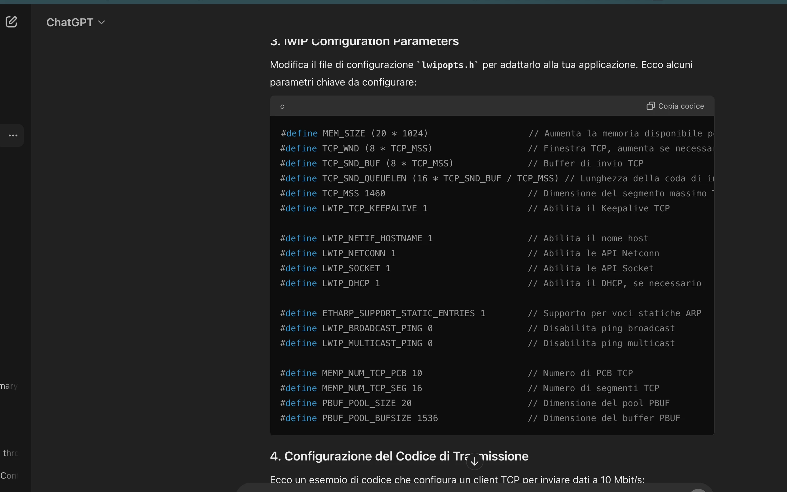

Jul 28, 2024 5:17 PM UTC
I tried with 32 TX descriptors and 32 RX descriptors and with the lwip configuration that I attached to this message. The max rate I got was 42,5 Mbit/s (measured through Wireshark) (I send 10486 bytes every 1ms), I also tried with other configurations of lwip parameters up to MEM_SIZE: 100*1024 bytes, TCP_SND_BUF: 70*1460, TCP_SND_QUEUELEN: 1120, TCP_WND: 70*1460, MEMP_NUM_PBUF: 64, PBUF_POOL_SIZE: 80, PBUF_POOL_BUFSIZE but the rate is fixed at 42,5 Mbit/s. I don't know what to do.
