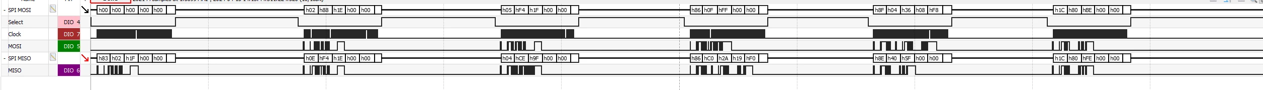

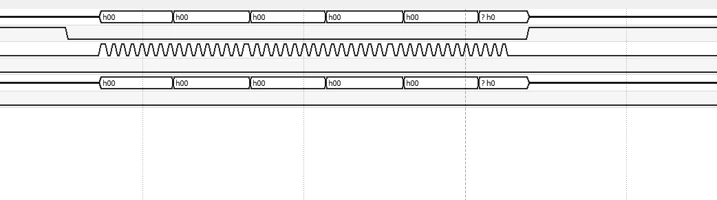

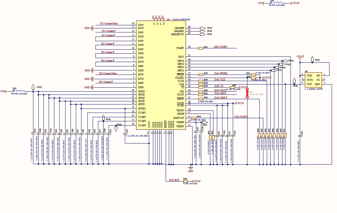

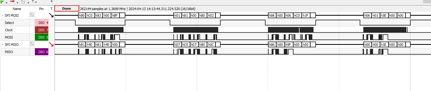

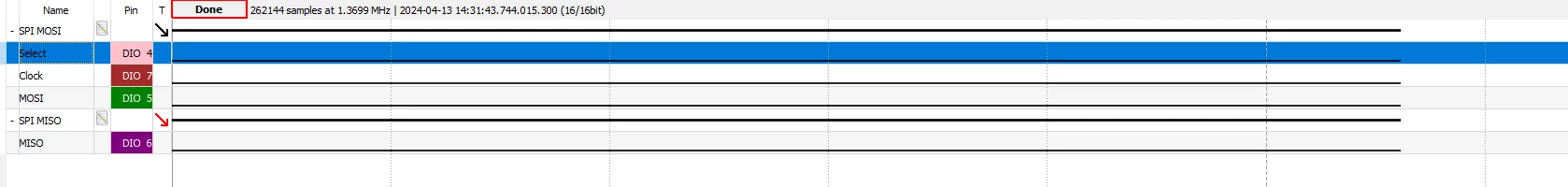

Hello All,
I hope you are all doing well !

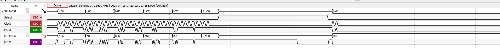

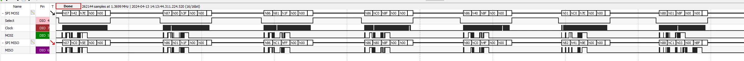

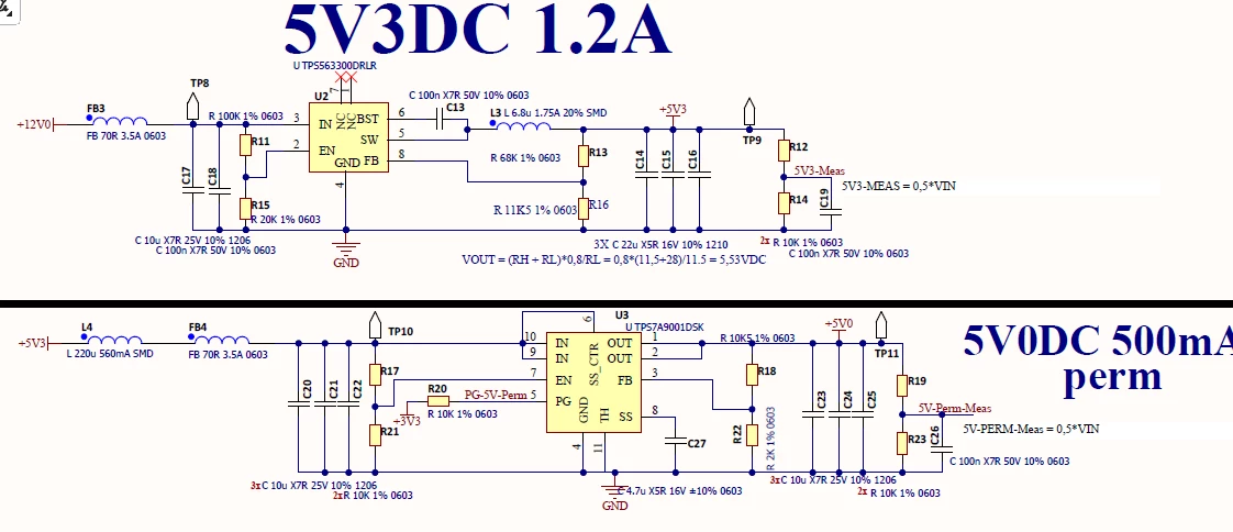

I m writing to ask help, I have problem with my STM32f765vit6 and an  ADS131e08 .
My the ADS131E08 stops communicating over SPI in continuous mode after a few seconds and block the SPI communication again. But with a Hardware reset and During this,It works Fine but abnormal values are recorded, and the periode to read values is limited due to the hardware reset.
Issue: The ADS131E08 stops communicating over SPI in continuous mode after a few seconds without a reset before blocking SPI communication. However, it operates in discontinuous mode with a hardware reset and delay. During this, either abnormal values are recorded, or it works continuously for approximately one hour .
Could anyone please provide insights or suggestions on resolving this issue where the device stops working in continuous mode?

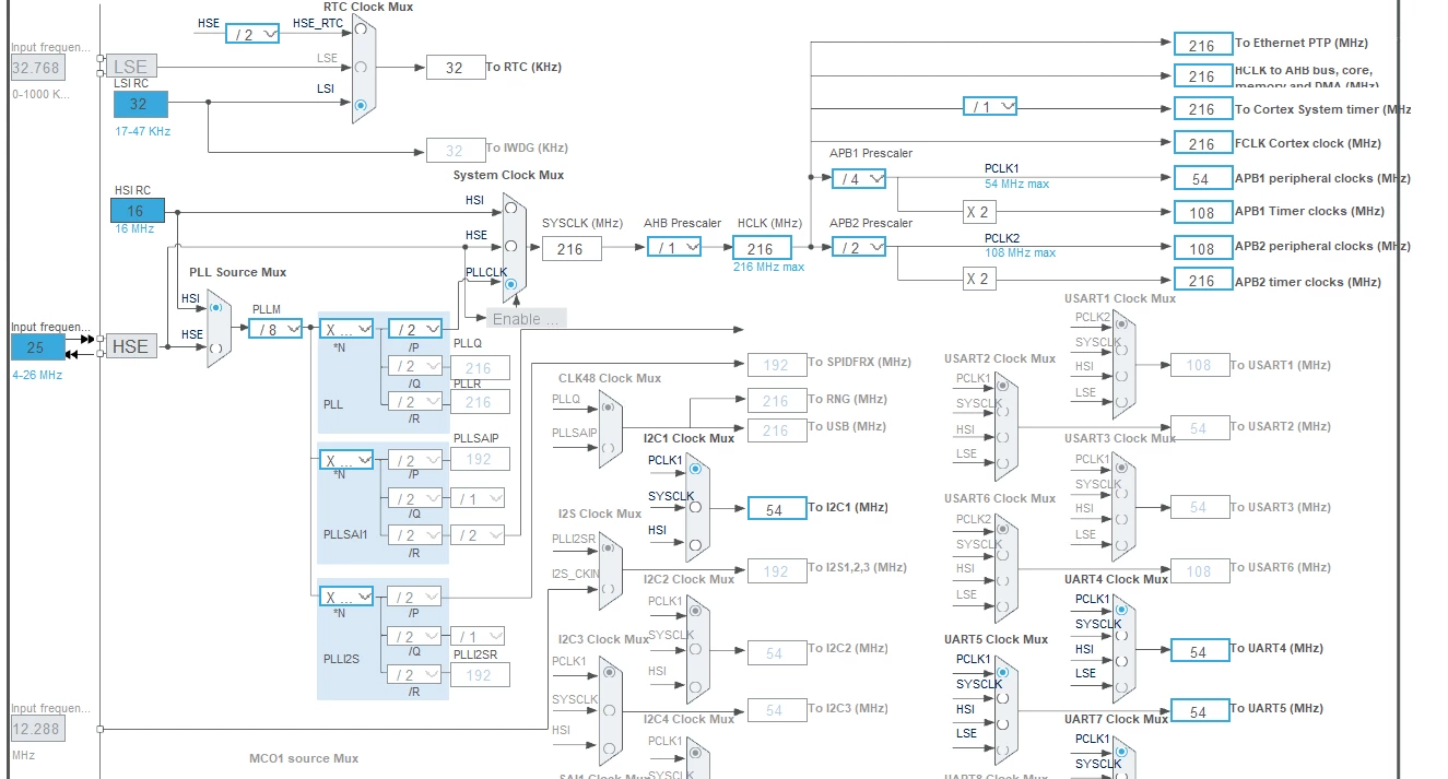

is there any chance to be a frequence configuration issue or is it a hardware issue ?
there any guidance to configure the clock correctly
Any guidance on troubleshooting this behavior would be highly appreciated.
best regards,
Azer.

void SystemClock_Config(void)
	__HAL_RCC_PWR_CLK_ENABLE();
	__HAL_PWR_VOLTAGESCALING_CONFIG(PWR_REGULATOR_VOLTAGE_SCALE1);
	RCC_OscInitStruct.OscillatorType = RCC_OSCILLATORTYPE_HSI|RCC_OSCILLATORTYPE_LSI;
	RCC_OscInitStruct.LSIState = RCC_LSI_ON;
	RCC_OscInitStruct.PLL.PLLSource = RCC_PLLSOURCE_HSI;
	RCC_OscInitStruct.PLL.PLLM = 8;
	RCC_OscInitStruct.PLL.PLLN = 216;
	RCC_OscInitStruct.PLL.PLLP = RCC_PLLP_DIV2;
	RCC_OscInitStruct.PLL.PLLQ = 2;
	RCC_OscInitStruct.PLL.PLLR = 2;
		Error_Handler();
	/** Activate the Over-Drive mode
	if (HAL_PWREx_EnableOverDrive() != HAL_OK)
		Error_Handler();
	RCC_ClkInitStruct.APB1CLKDivider = RCC_HCLK_DIV4;
	RCC_ClkInitStruct.APB2CLKDivider = RCC_HCLK_DIV2;
	if (HAL_RCC_ClockConfig(&RCC_ClkInitStruct, FLASH_LATENCY_7) != HAL_OK)
		Error_Handler();

I] Shematic :
This the shematic of the ads131e08 with the Stm32
and  the ADC is powered via this two blocks  with 500ma Capabilities, normally the ADC consumes less than 10mA
II] MX configuration
III] oscilloscope :
ads blocked when i put it in continous mode without reset:
