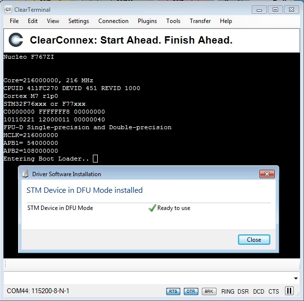

Ok, so confirming the F769I-DISCO is problematic, it doesn't have a USB-FS port, and the VCP on USART1 is not viable, likely due to the number of pins on the device and their assorted states. The USART should auto-baud via a TIM measuring the 0x7F pattern.
I was able to use the USB-FS on the NUCLEO-F767ZI

Have just tried a NULEO-F756ZG board and as you say that works fine with the internal bootloader, at least on the USB_FS interface (haven't tried any serial ports). This has the CPU clocked from an external 8MHz source, so the bootloader, in general, appears to work with external clock sources. As expected this board raises the USB_FS D+ line even without any USB cable so that a host can detect its presence. In fact if I disable the external clock source so it has to use its HSI clock, it still puls the USB D+ line high although, as expected, it won't connect to the USB host. So the clock source should not affect the bootloader initialising the USB_FS device and setting USB_FS D+ high.
With the STM32F765 processor on our board and on the F769I-DISCO the USB_FS D+ line is never pulled high.
