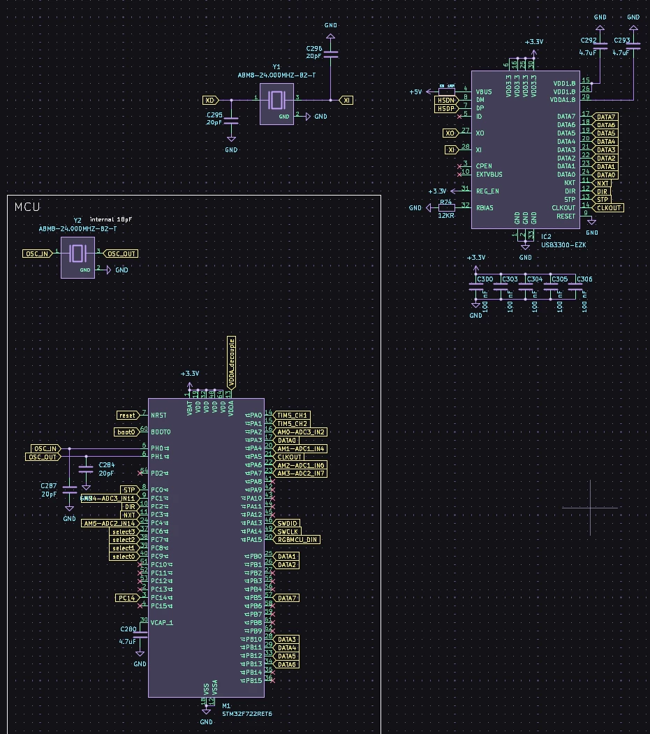

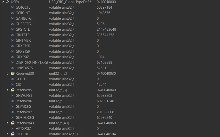

I am trying to use ULPI with external HS USB phy with the follwing schematic:
when calling MX_USB_DEVICE_Init(), it will be stuck at
 /* Required few clock cycles before accessing USB PHY Controller Registers */
for (volatile uint32_t i = 0; i < 10; i++) {
__NOP(); // No Operation instruction to create a delay
/* Core Soft Reset */
USBx->GRSTCTL |= USB_OTG_GRSTCTL_CSRST;
do
count++;
if (count > HAL_USB_TIMEOUT)
return HAL_TIMEOUT;
} while ((USBx->GRSTCTL & USB_OTG_GRSTCTL_CSRST) == USB_OTG_GRSTCTL_CSRST);
return HAL_OK;
in USB_CoreReset(), eventually returning HAL_TIMEOUT.

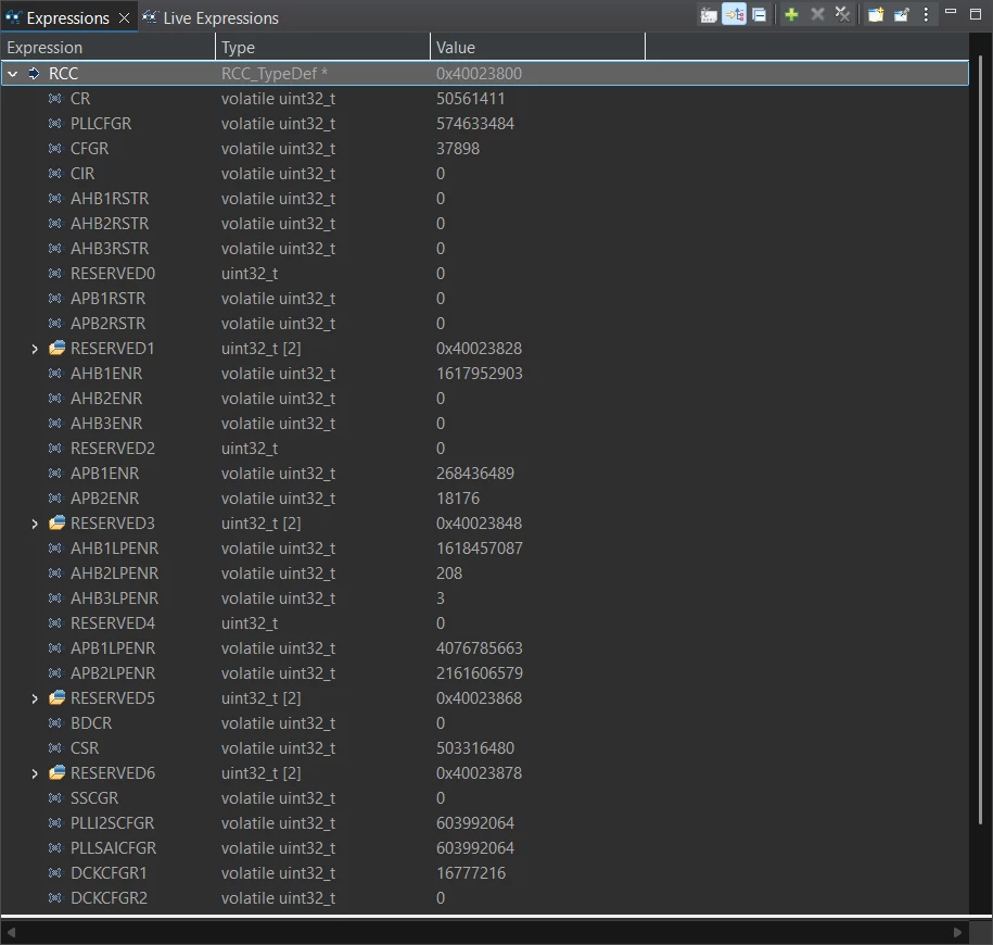

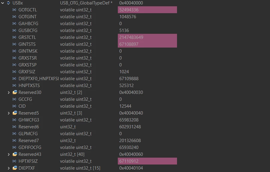

Images of USBx and RCC:
USBx before core soft reset
USBx after soft core reset
RCC before & after soft core reset

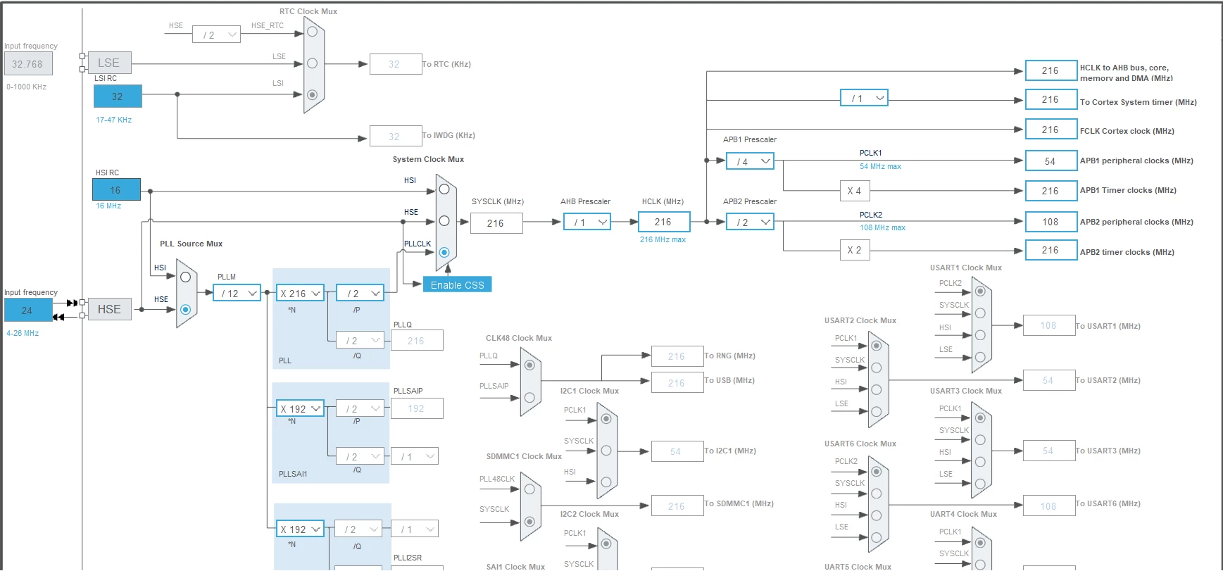

My clock configuration, everything not included in this image is greyed out

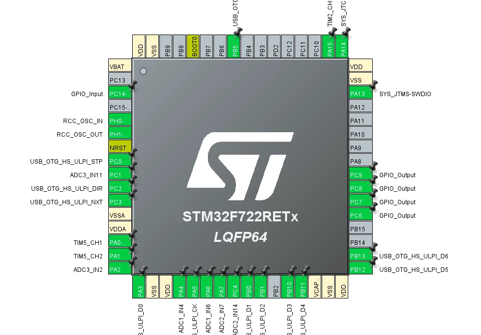

ULPI pins:
 /**USB_OTG_HS GPIO Configuration
PC0 ------> USB_OTG_HS_ULPI_STP
PC2 ------> USB_OTG_HS_ULPI_DIR
PC3 ------> USB_OTG_HS_ULPI_NXT
PA3 ------> USB_OTG_HS_ULPI_D0
PA5 ------> USB_OTG_HS_ULPI_CK
PB0 ------> USB_OTG_HS_ULPI_D1
PB1 ------> USB_OTG_HS_ULPI_D2
PB10 ------> USB_OTG_HS_ULPI_D3
PB11 ------> USB_OTG_HS_ULPI_D4
PB12 ------> USB_OTG_HS_ULPI_D5
PB13 ------> USB_OTG_HS_ULPI_D6
PB5 ------> USB_OTG_HS_ULPI_D7
GPIO_InitStruct.Pin = GPIO_PIN_0|GPIO_PIN_2|GPIO_PIN_3;
GPIO_InitStruct.Speed = GPIO_SPEED_FREQ_VERY_HIGH;
GPIO_InitStruct.Alternate = GPIO_AF10_OTG_HS;
HAL_GPIO_Init(GPIOC, &GPIO_InitStruct);
GPIO_InitStruct.Pin = GPIO_PIN_3|GPIO_PIN_5;
HAL_GPIO_Init(GPIOA, &GPIO_InitStruct);
GPIO_InitStruct.Pin = GPIO_PIN_0|GPIO_PIN_1|GPIO_PIN_10|GPIO_PIN_11
|GPIO_PIN_12|GPIO_PIN_13|GPIO_PIN_5;
HAL_GPIO_Init(GPIOB, &GPIO_InitStruct);

Hello ​@stm31
As a start, I noticed that you have OTG_HS_ULPI_NXT pin assigned to PC3 but in the datasheet it needs to be assigned to PH4 pin
Can you see if this solves your issue or there are other issues
BR
Gyessine
stm31Author
Jun 18, 2026 09:21 UTC
Hello, I am using LQFP64 package which does not have PH4 pin, NXT is mapped to PC3 according to datasheet and CubeMX

waclawek.jan
Jun 18, 2026 12:56 UTC
GRSTCTL_CSRST not autoclearing typically means that you don’t have PHY clock, here 60MHz to be supplied via PA5=OTG_HS_ULPI_CK from PHY’s CLKOUT pin. Observe at PA5, using oscilloscope or logic analyzer, presence of that clock.
working (both PCB measures to this value prior to flashing new code):
XO measures ~1.8V
defective:
no voltage across XI & XO
This indicates that the PHY does not work. If 3.3V supply is OK, 1.8V output at both capacitors is OK and all supply and ground pins are connected properly (including pad of the QFN package!), then the problem may be related to the crystal oscillator. Often crystal oscillators won’t work properly due to improper layout, mainly the ground return from the “burden” capacitors, or improper values of those capacitors. You can - as an experiment - try to replace the crystal by a crystal oscillator, or any other suitable 24MHz clock source.
stm31Author
Jun 18, 2026 13:20 UTC
Hello, I dont have any other oscillators in hand, so I am unable to experiment with other sources. But the clock only stopped working if i flashed code onto it. I just measured from a blank PCB which showed symtoms of a working clock (voltage across XI & XO and CLKOUT), so I think it’s safe to assume that the crystal oscillator is working properly. I also created another project with no USB related code and flashed it on to a defective board, and the PHY clock started working but still cannot connect to PC as USB has not been initialised.
waclawek.jan
Jun 18, 2026 13:35 UTC
I don’t think the PHY’s oscillator can normally be influenced by code.
Single-step (or bisect using breakpoints) through your offending code to find out the point where does the oscillator stop.

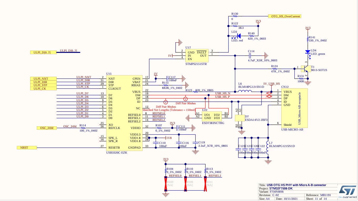

You can refer to the example configuration provided and attached schematics
Probe the 60 MHz clock on PA5 with an oscilloscope and confirm it is present and stable before USB core reset. Also check that DIR and NXT are toggling during bring-up and that the PHY reset is released only after the supply rails and crystal oscillator are stable.
