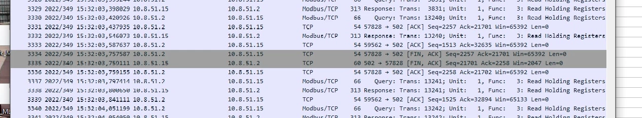

In addition, I attach a wireshark capture when the master (10.8.51.2) request the end of the connection and the problem doesn´t occur:

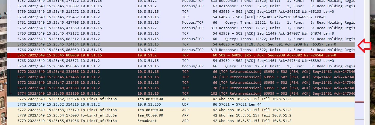

But when the problem occasionally occurs, there is a RST:
0693W00000WL8B7QAL.pngPlease consider in both captures that I have more than one connection at the same time between master and slave, that's the reason there is activity after the desconnection (belongs to other ports

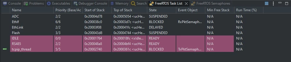

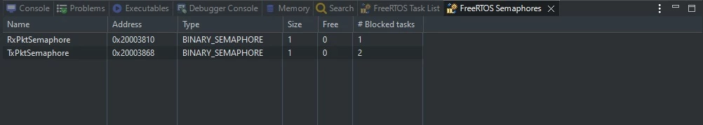

leoneln
leonelnAuthor
Dec 16, 2022 3:57 PM UTC
Hi, thanks for replying
I did what you suggest and here is the capture:
There is a callback interruption that releases the semaphore:
void HAL_ETH_TxCpltCallback(ETH_HandleTypeDef *handlerEth)
 osSemaphoreRelease(TxPktSemaphore);
The interrupt never seems to happen and of course this blocks execution.
