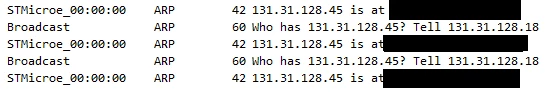

On boot the device transmits an ARP announcement. And when trying to send a test UDP packet the device sends an ARP request, this request is seen and a response given.
It looks like RX is failing in the device i.e. inside HAL_ETH_ReadData() we never enter:

I'm using a point-to-point connection to my laptop, no switch/router. Any pointers?

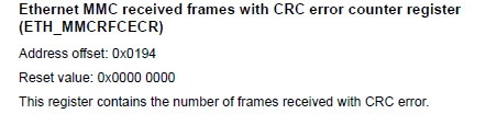

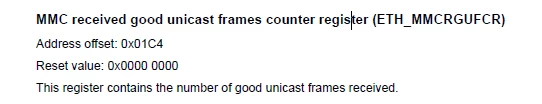

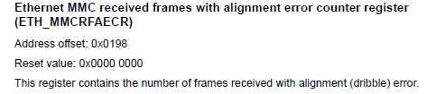

nick_bergAuthor
Nov 1, 2023 3:11 PM UTC
While looking at the registers I noticed that the MAC frame counters are not updating.
So this is starting to look more like a MAC configuration error to me, not something with the DMA/LWIP.
