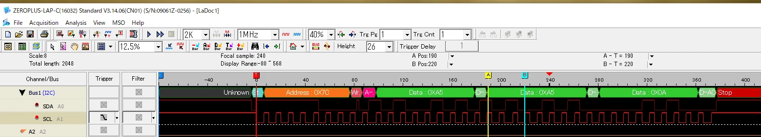

I found very strange behavior of the STM32F7 HAL I2C. Please see the description below.
I have also attached problem demonstration program and screenshot.
Regards,
Seiichi

========== Problem ===========
In the I2C Slave RX operation with interrupt API ( HAL_I2C_Slave_Receive_IT() ),
the HAL doesn't generate NACK while the given receive buffer is full.
Also, HAL triggers error callback with AF status, when transmitter stops before the
given receive buffer is full. In this case, the received byte count is unable to calc.

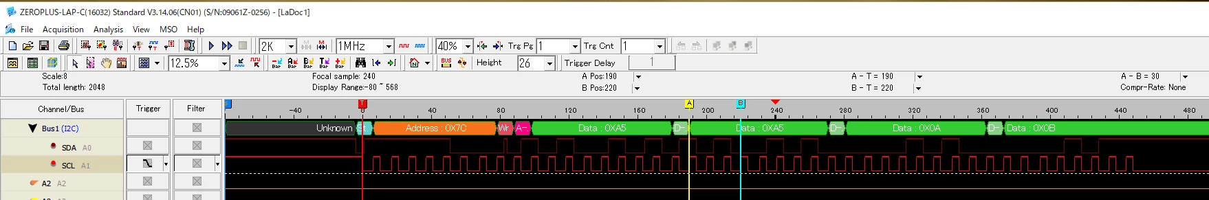

========== Result ===========
TX_SIZE, RX_SIZE,, Transfered[Bytes] , ACK/NAK, XferCount, call back, Comment
2 3 2 ACK 0 error(AF)
2 2 2 ACK 0 cplt
3 2 2 ACK 0 cplt (*1)
4 2 2 Clock Strech (*2)
(*1) See MasterTx_3B_SlaveRx_2B.PNG. Slave send ACK, while it shold send NACK.
(*2) See MasterTx_4B_SlaveRx_2B.PNG, Slave send ACk, while it should send NACK.Clock stretch occurs.
