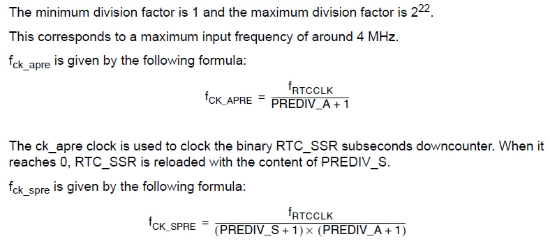

Hello everyone,
I have ported the following RTC_Calender example to STM32F4-Discovery board.
STM32Cube_FW_F4_V1.1.0\Projects\STM324xG_EVAL\Examples\RTC
I was logging the date & time along with subseconds feature ( as mentioned in stm32f4xx_hal_rtc.h file, its range is 0 to 59). But this value range depends on AsynchPrediv & SynchPrediv of RTC_InitTypeDef structure. I'm using LSI as RTC clock. Page 782 of stm32f4Reference manualRM0090 says: 0690X00000605eyQAA.png where AsynchPredivis PREDIV_A and SynchPrediv is PREDIV_S. currently I configured AsynchPrediv=0x7F and SynchPrediv= 0xFF I log the date, time in a while(1) loop :

3 replies
gk_it
May 28, 2014
Posted on May 28, 2014 at 10:08
Setup 32bit timer (TIM5) with 1us tick and reload after 3599999999 (one hour).
Optional on timer reload : counting hours + calendar.
Reading one hour time is fast, just read timer CNT, but with hours + calendar CNT need to be read double time: before read hours + calendar structure and after to avoid hour tick mistake.
harinath
harinathAuthor
July 17, 2014
Posted on July 17, 2014 at 04:02
Thanks for the explanation.
I couldn't understand
would you explain it please.
Tesla DeLorean
Guru
July 17, 2014
Posted on July 17, 2014 at 18:08
When reading a time/date across multiple variables one trick to ensure you aren't at a roll-over event is to read the values twice until they remain the same.
