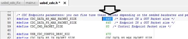

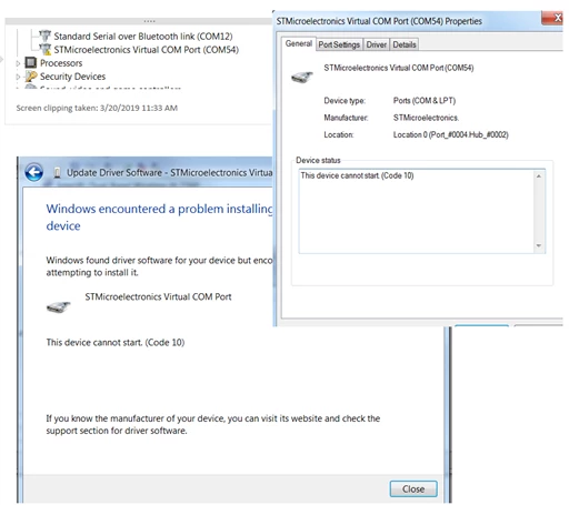

Hi, in case someone else have the same issue which is Installed the WIN7 64Bits USB Virtual COM Port cant't start with Code 10,
Software and Library versions,
  1. I am using Firmware Library "STM32Cube_FW_F4_V1.24.0"
  2. STM32CubeMX V5.0.1 and STM32Cube V1.0
  3. IAR Embedded Workbench for ARM (8.32.2.19423)
  4. IAR Embedded Workbench shared components (8.2.2.5792)
  5. Board: STM32F4VET6
  6. OS: WIN7 64Bits

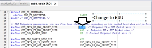

To correct this, we have to fix the Endpoint IN & OUT Pakcet Size “CDC_DATA_HS_MAX_PACKET_SIZE “within the “usbd_cdc.h�? header file.
OLD
/* CDC Endpoints parameters: you can fine tune these values depending on the needed baudrates and performance. */
#define CDC_DATA_HS_MAX_PACKET_SIZE 512U /* Endpoint IN & OUT Packet size */ //<-- Change 512U to 64U
#define CDC_DATA_FS_MAX_PACKET_SIZE 64U /* Endpoint IN & OUT Packet size */
#define CDC_CMD_PACKET_SIZE 8U /* Control Endpoint Packet size */
NEW
#define CDC_DATA_HS_MAX_PACKET_SIZE 64U // 512U /* Endpoint IN & OUT Packet size */
Save, Recompile and Rebuild your code.

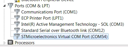

Unplug the USB and re-plug it back it for the USB port Communication recycle , not the ST-Link, the device driver should refresh, and it start working properly.
Hope this helps!
