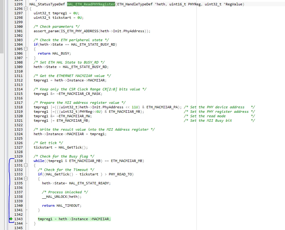

STM32F4x HAL_ETH_ReadPHYRegister blocking mode
Dear all
After having enabled ETH + LwIP stack we are experiencing that something in the init phase are keeping blocked all.
After a while we see that the root causes is inside HAL_ETH_ReadPHYRegister.
Specifically we are referring at this part of code:
0693W00000GXG4xQAH.pngIs there any way to make this in a better way?

Pavel A.
Nov 12, 2021 1:26 AM UTC
As you see from the code, reading the PHY register has timeout and should not loop forever.
Check that the HAL timer runs, isn't obstructed by a higher priority interrupt etc.
Davide Dalfra
Nov 12, 2021 9:22 AM UTC
Hi
Yes, the timeout in a way or in another finish. When i said all , i mean all "for a certain period of time".
I was wondering of a way to have a non-blocking mode for this.

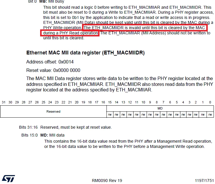

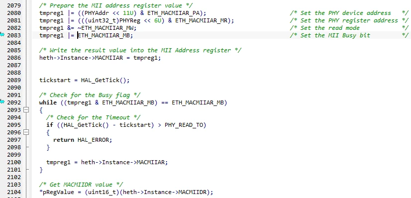

Let's agree first on one point:
  • Before the while loop, there is the write of MACMIIAR register.
  • After the while loop there is a read from MACMIIDR register
0693W00000YAUeMQAX.pngAs you can see in reference manual extract below, the MACMIIDR is invalid until the busy flag is cleared. So before reading MACMIIDR, user must wait until busy flag is cleared.
So, we think The simple way to do deal with the problem described here, is to set PHY_READ_TO to 0.
Otherwise, when set the busy flag ETH_MACMIIAR_MB indicates that a read or write operation is ongoing. So you should wait until the bit is cleared.
I hope it helps.
