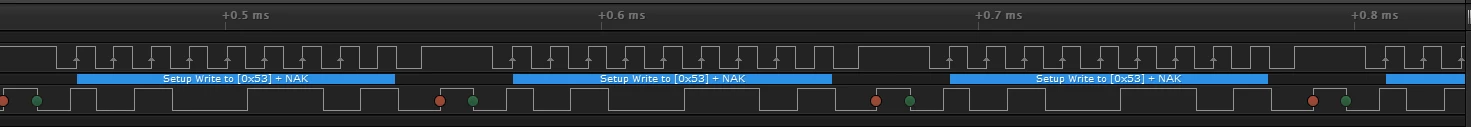

thank you for replies, as you said I checked the I2C lines response and result is the NACK. According to the
ADRESS_ALT_0(SDO ground & devadress = 0x53) and
ADRESS_ALT_1 ( SDO vcc & 0x1D device adress )
are tried. Every time I get NACK. I guess problem is about the sensor board. I attached the latest code.

The Logic Analyser Result;
Thank you all for responses and helps.
Best Regards
AvaTar
Senior III
March 7, 2018
Posted on March 07, 2018 at 07:22
In the 9.th bit cycle, the master switches SDA from output to input, and leaves it floating.
The slave is supposed to pull SDA low then, as acknowledge.
This does happen nowhere, so the slave does not 'feel addressed'.
