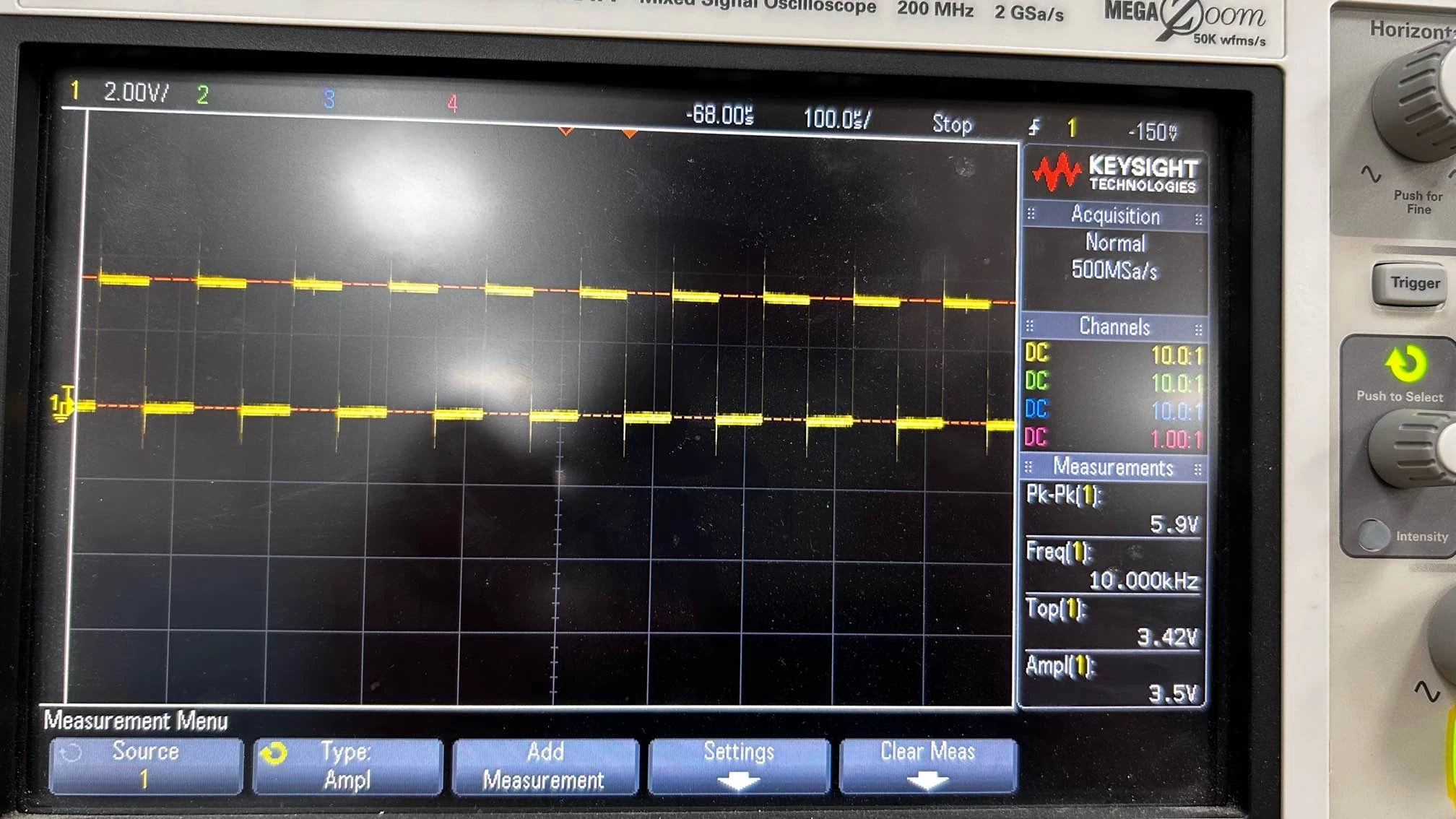

attached scope pic:

Hello @Murali3252
By testing a few examples for the STM32F446RE, I have tried to reproduce the issue.
For example TIM_PWMInput, It uses the TIM to measure the frequency and duty cycle of an external signal. As in your code 10KHz PWM using TIM1, I have modified the code to suit the configurations, and I am getting a pk-pk voltage of around 6 volts, Ampl around 3.3 volts.
You can generate an example for the TIM using CubeMX or check the STM32F4 firmware package to verify your code. It may also be a wires problem.
Attached pic for oscilloscope visualisation:
