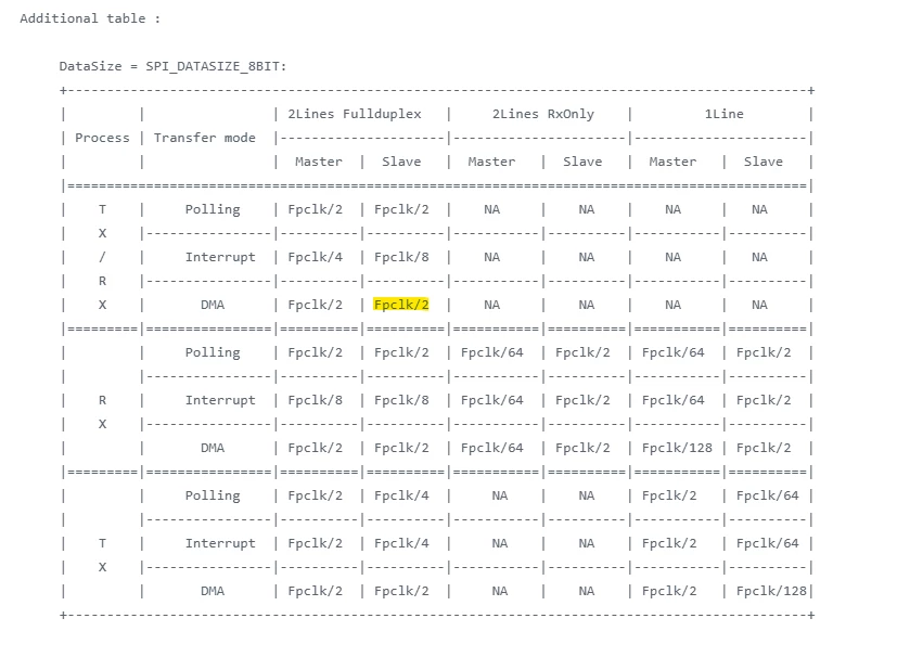

However, we suspect that the default AXI SPI clock from the FPGA might be too fast for the STM32 to sync properly at the very first falling edge of the NSS line. Given the APB peripheral clock constraints on the STM32F446, what would be the maximum recommended SCK frequency for the Slave to achieve reliable latching without missing the initial clock pulses?
Jun 26, 2026 11:08 UTC
Hello ​@Kevindied
The maximum reliable SPI SCK frequency in slave mode is approximately Fpclk/2 for 8‑bit data size in this configuration.
In order to give better visibility on the answered topics, please click on 'Best answer' on the reply which solved your issue or answered your question. Saket_Om
