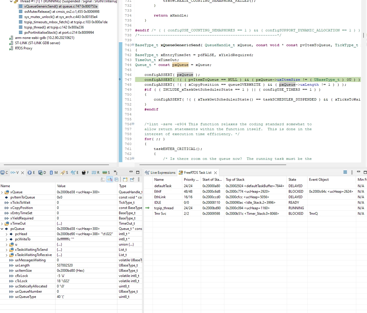

stm32f439 freertos lwip stuck
Hi, i have build up a basic freertos and lwip setup. I just have one user task running.
I start a sntp to get the time and wanted to print the time in that task. But it does not reach there.
I get stuck. I'm using the cmsis v2 i recently upgraded the toolset of the IDE.
When i switch back to cmsis v1 it works. Any ideas?
Thanks

Ideas? Keep using CMSIS RTOS v1. It is not broken.

Hello @MOtto.2
Can you share your project here and indicate the modifications you've done between both working and not working projects.
