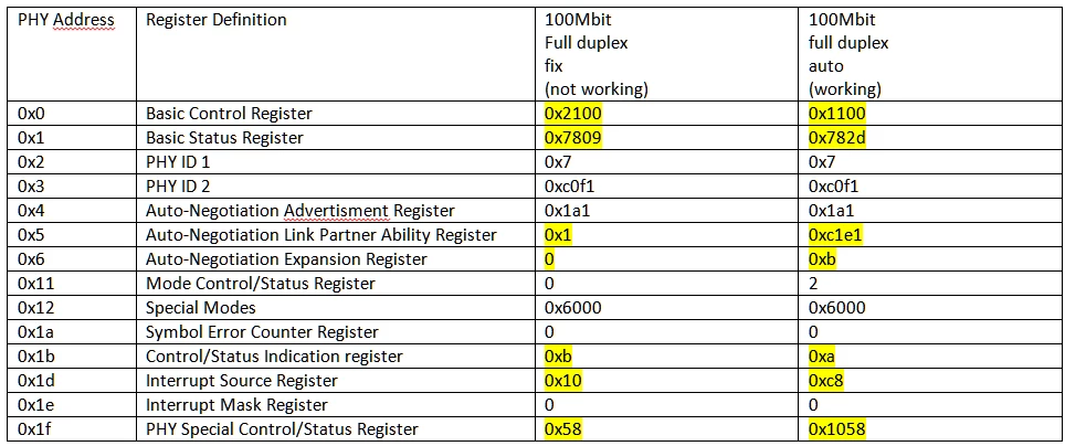

0690X000008iBMOQA2.pngI am struggling with the original thread: When I dont use autonegotiation, it doesnt work. Not on the M4, not on the M7.
If I use autonegotiation, 100MBaud full duplex is selected.

In the attached picture, there are my registers, for both fix and auto-negotiated.
Anyone has a clue? Every hint is appreciated.
