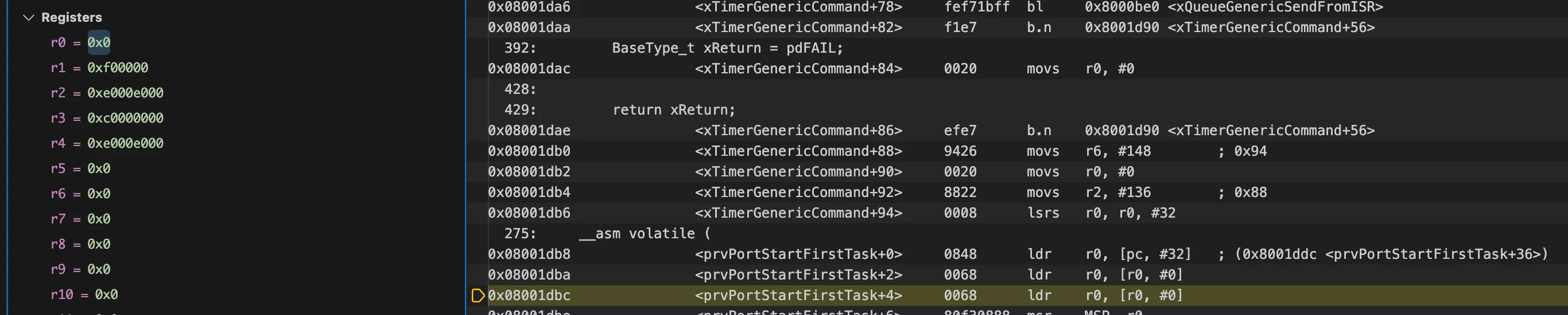

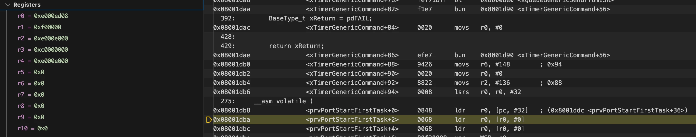

after dissamebly looks like this:
after i step to next line, r0=0x0

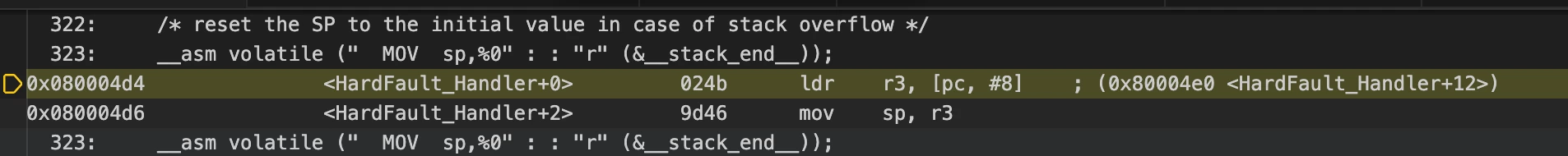

when i want to go next line, i end up in hardfault handler:
CFSR, HFSR:
0xe000ed28: 0x00000082 0x40000000 0x00000001 0x00000000
reading CFRS i know that  Data Access Violation occurred but my question is why?
