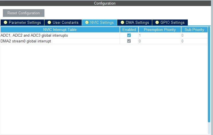

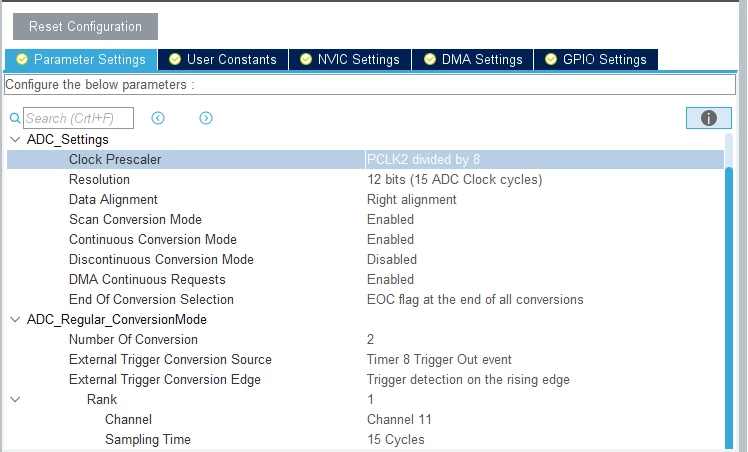

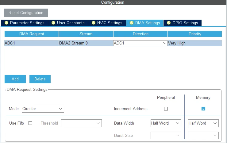

HJung.6
HJung.6Author
November 1, 2019
add mxcube setting.
