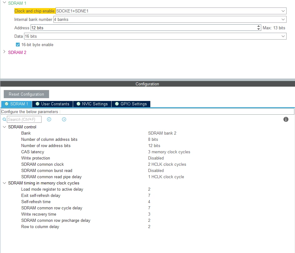

hello i have stm32f429i-disco card. fmc settings are configured. i defined sdram in the linker file but variable sdram is not written. can you help me? i am using cubeide. my linker file is attached and i am attaching the photo of my fmc settings. my variable definition is as follows __attribute__((section(".sdram"))) uint8_t frame_buffer[320 * 240 * 2];

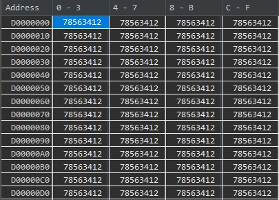

Did you try to read it back in the code? I think this is something expected while reading the SDRAM content from the watch.

Before going ahead with linker configuration, were you able to write a variable using a pointer?
For the SDRAM timings, did you refer to the SDRAM example provided in the STM32CubeF4 package?: https://github.com/STMicroelectronics/STM32CubeF4/tree/master/Projects/STM32F429I-Discovery/Examples/FMC/FMC_SDRAM

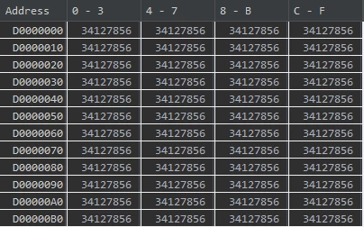

I found what I was missing from the file you linked and added it and I can write data to sdram. But the data I write is in a mixed order. I am putting the code I wrote below as a picture and the value I read from memory in debug.
 uint16_t *sdram_address = (uint16_t *)0xD0000000;
 for (uint32_t i = 0; i < 1024; i += 2)
 sdram_address[i] = 0x1234;
 sdram_address[i + 1] = 0x5678;
edramdenAuthor
May 8, 2025 6:50 PM UTC
 uint32_t *sdram_address = (uint32_t *)SDRAM_BANK_ADDR;
 for (uint32_t i = 0; i < 1024; i++)
 sdram_address[i] = 0x12345678;
