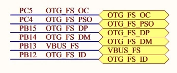

Zan Gligorov
April 3, 2018
Posted on April 03, 2018 at 01:50
Thanks Clive.  The schematic seems to show the user USB is FS, and not HS.   Also I have found instructions on how to do that in older materials, just not sure if the new  version of the board, the DISCO1, has any changes in that aspect. Here is the schematic for the USB.
