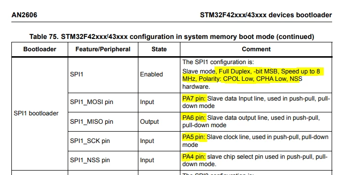

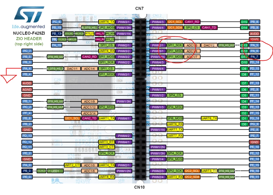

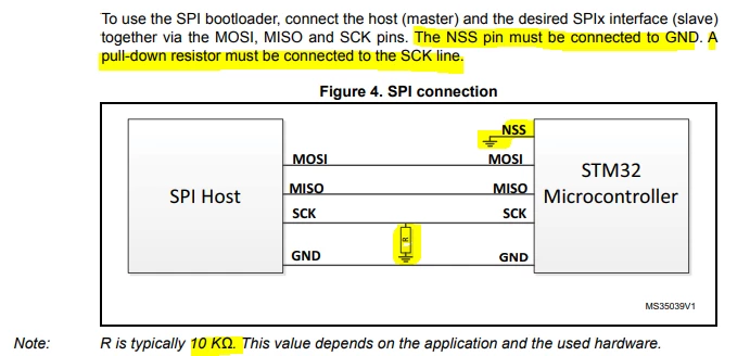

I'm having trouble getting into SPI bootloader mode on SPI1 using NUCLEO-F429ZI.

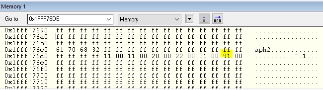

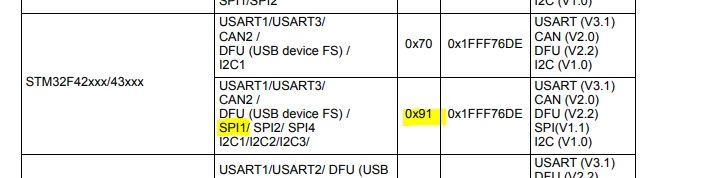

I have verified this:
0693W00000UFPq7QAH.pngI have followed this:
0693W00000UFPtBQAX.pngAnd used these pins and SPI mode:

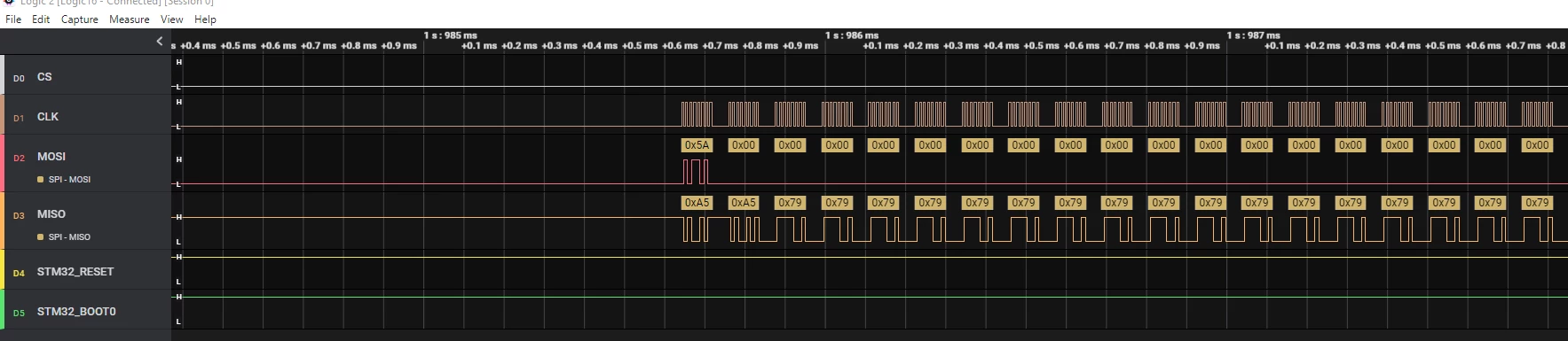

0693W00000UFPqlQAH.pngBut I still don't get any responce:

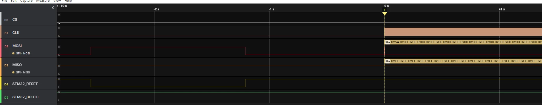

Full sequence från me pushing the reset button and my second board sending the Synchronization Byte:

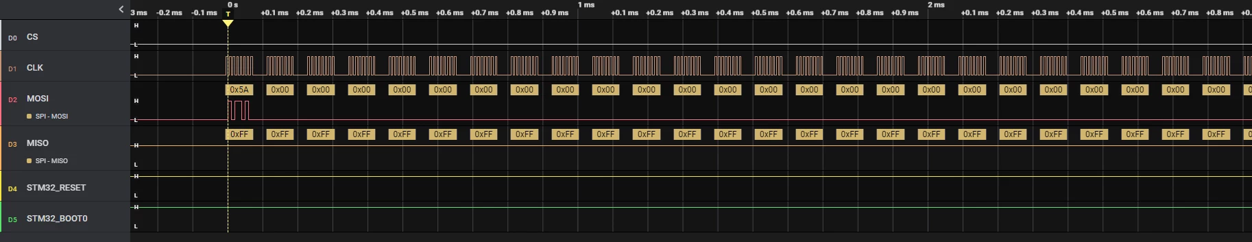

0693W00000UFPrPQAX.pngDetails when sending 0x5A (Synchronization Byte):
0693W00000UFPrZQAX.pngWhat am I doing wrong here?
I have a simple LED blinky program on the MCU (that it boots to when BOOT0 is low). I can see that it boots into bootloader mode at least beacause it doesn't blink the LED anymore. But I't doesn't respond.
