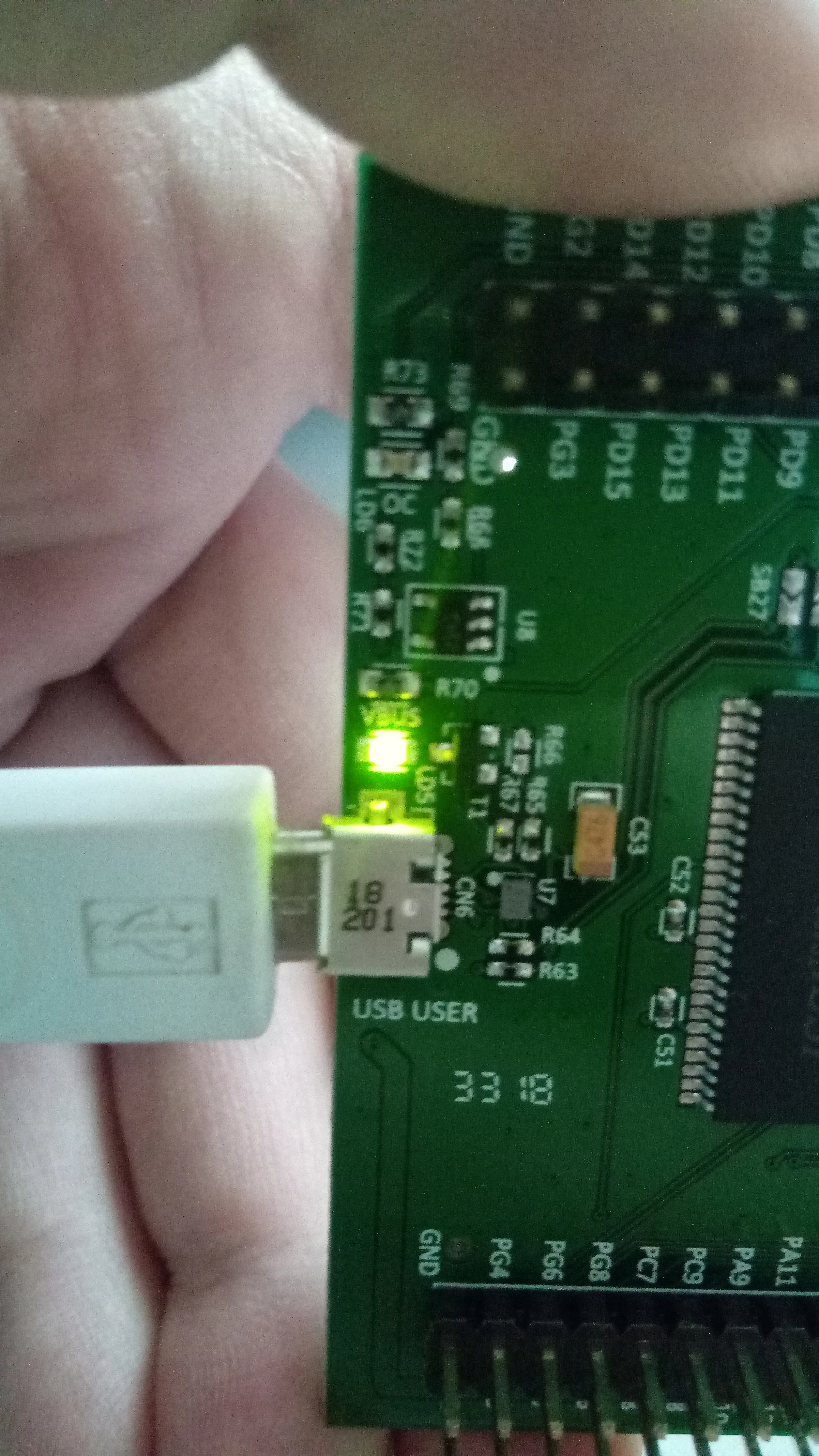

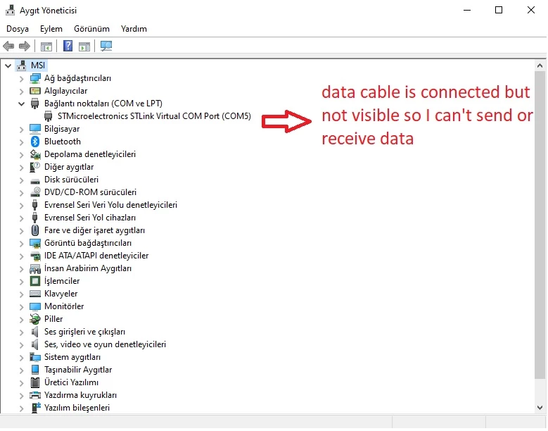

I have the STM32F429 Discovery development board. I want to send and receive data from the USB port. I will use Virtual Com Port for this. When I connect the Micro USB port on the card to the computer, it does not appear as a device. I use Keil as the compiler. My operating system is Windows 10.

You have installed a driver on your PC, but apparently there is no driver on the STM32F429.
Try compiling and installing an USB example from STM32CubeF4.

"data cable is not visible" ? You can't see the cable plugged into the board? I don't know how to parse this, seems like all is working correctly to me.

And what is that virtual COM Port thing in the device manager?​

I installed the driver I mentioned above for this. But the computer does not see the card still connected. What should i do for the computer to see the micro usb connection ?? Is there anyone who can help ?

Before seeing your suggestion, I solved my problem by using the example below. Thank you to Mr. Majerle and you.
https://stm32f4-discovery.net/2014/08/library-24-virtual-com-port-vcp-stm32f4xx/
