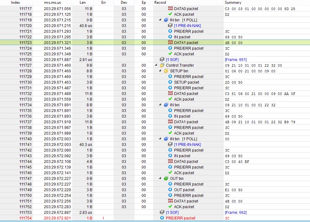

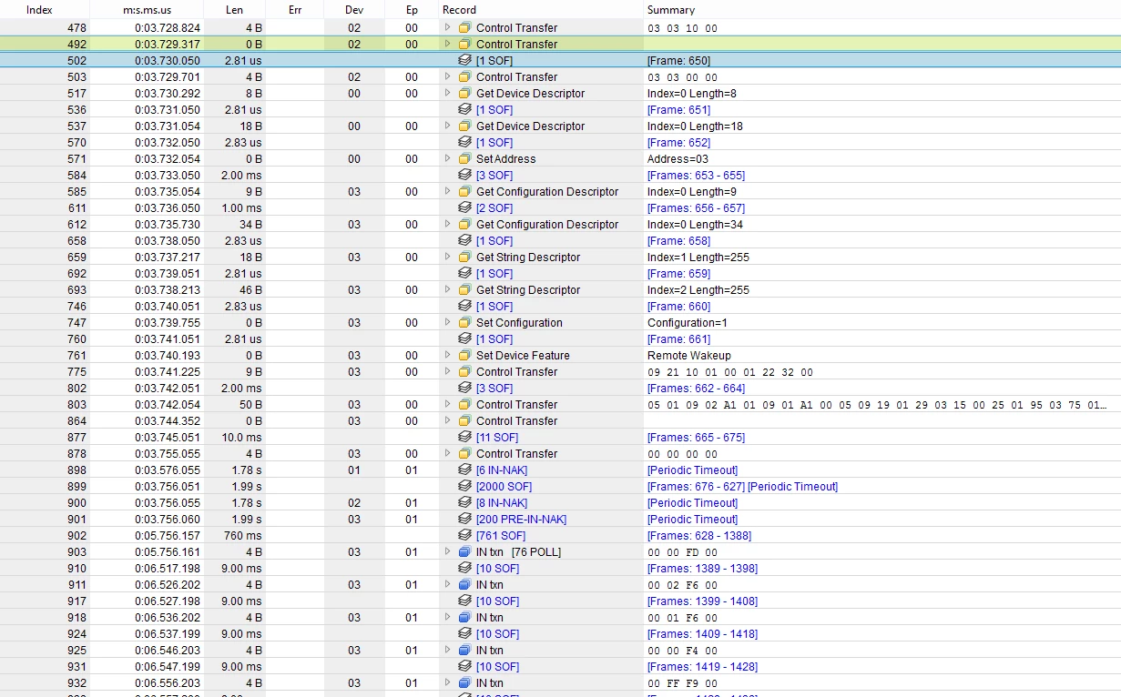

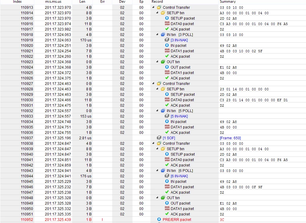

I managed to get my Hands on a beagle 12 USB Protocol Analyser. I was able to catch the Error with this very useful tool:
one picture shows the error after the first Pre PID was send. The other pictures shows the error a bit later after a few successful transfers. But everytime the PRE PID is the last information send by the Host before the Host gets shut down completly. There are no SOF or anything else coming from the Host..

I came to the same conclusion when attempting this a couple of months ago, also observing the traces on an USB-analyzing-enabled LA.
Btw. I haven't had the liuck you had:
> The weird thing is now that the enumeration of Low-Speed devices is only working about 50% of the time.
I never gotten beyond enumeration with a LS device behind a FS hub. I'd say, this might be timing related, either in hub, in the core, in software handling the core, or everywhere and anywhere.
This is obviously bug deeply in the core of the Synopsys IP. Very unlikely anybody can work around it without Synopsys support, and that won't happen until ST steps in hard.
And in the last years I haven't seen ST eagerly supporting the Synopsys OTP here or elsewhere. So, it's safe to assume this is broken beyond repair and work out of that premise.

Well Jan, don't ask me why it is working sometimes. Looking at the trace of a successful enumeration shows no difference in timing compared to a failed enumeration: 0690X00000AR8A3QAL.png
(I'm connecting a low Speed Mouse over 2 HUBs with the STM32)
Because of the fact that I got it working sometimes I thought it might be a simple timing error. But this trace says a different thing to me.
I also managed to get my successrate up in the 90% area after implementing a routine that resets the hostcontroller everytime there is an PortDisabled Interrupt. This is of course neither good enough nor anyting close to a programming practices I would allow in a finished product.

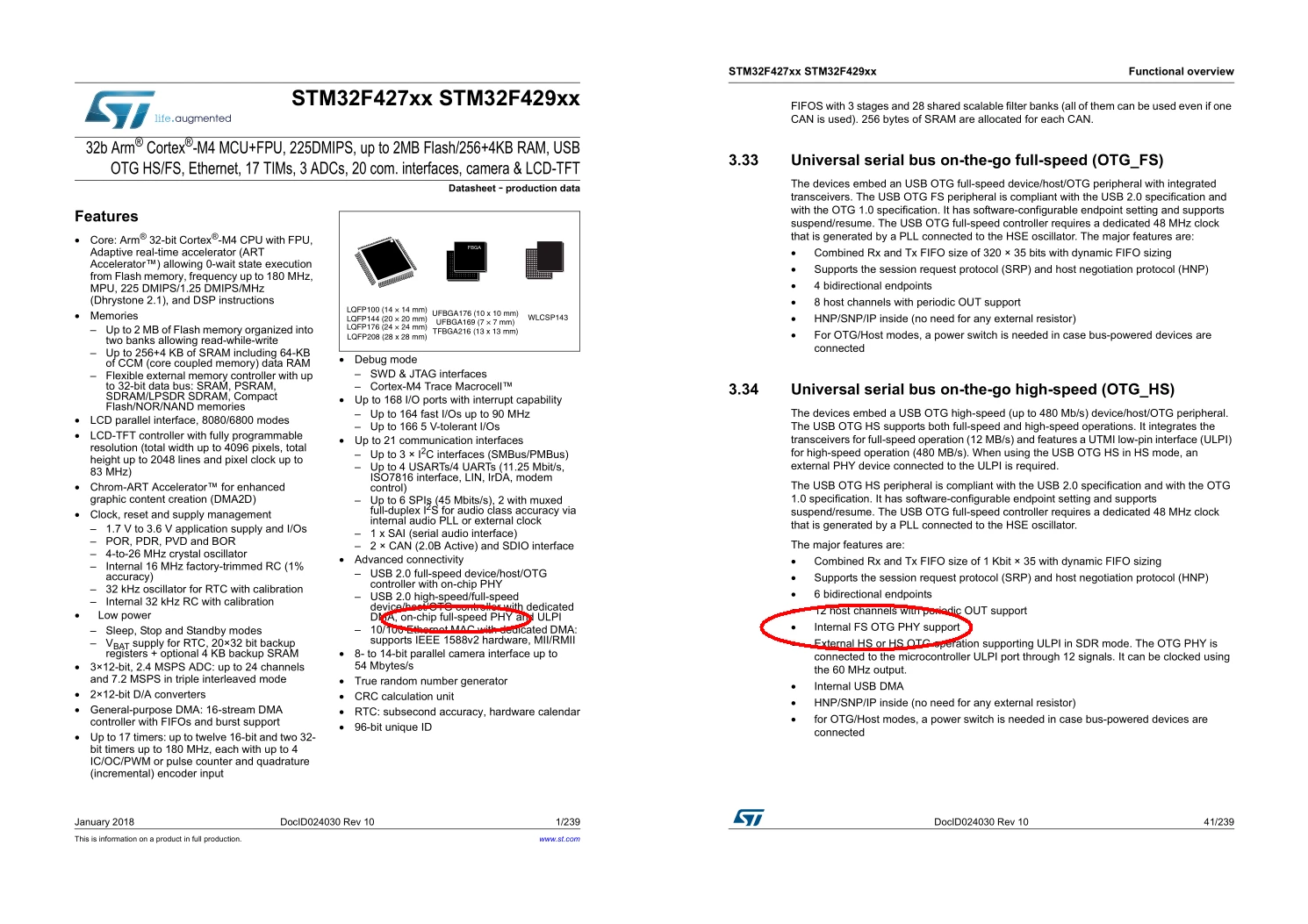

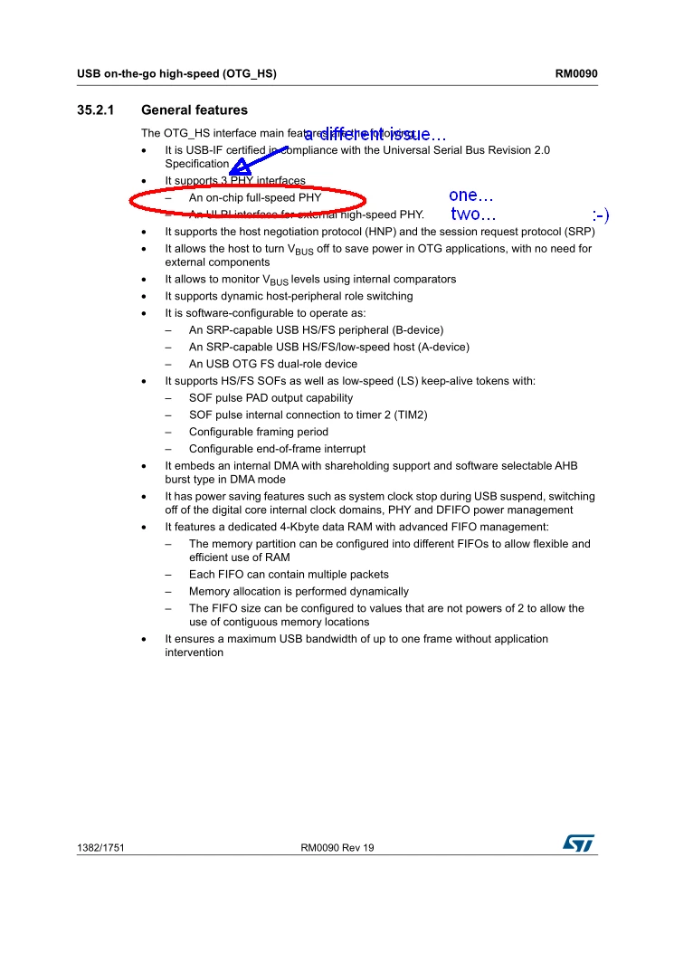

Q (Me): "do all products that have internal Full-Speed (FS) USB OTG PHY have the same silicon lithography design on the PHY module? Including the H7 line?
I ask this because I was thinking of making a new PCB board using MCU H743, but if the internal FS USB OTG PHY of H743 is the same as that of F407, then I will try to work around some problem locally"
A (STOne-32 - ST Employee) : "F4 and F7 series are build on 90nm Technology, H7 series are build around ST 40nm e-NVM node with a design-in-house Internal PHY - the H745 rev V is the last revision of silicon and you can refer to our Erratasheet for fixed limitations. You can also explore the H730 series they are cost effective if memory usage of embedded flash is not required"
https://stcommunity.st.com/t5/stm32-mcu-products/is-there-any-stm32-f7-or-h7-pin-compatible-with-stm32f407vgt6/m-p/568289/highlight/true#M216887
waclawek.jan
June 18, 2023
You should've asked, whether the bug described in erratum we are talking about here, applies to the FS PHY in 'H7 too.
