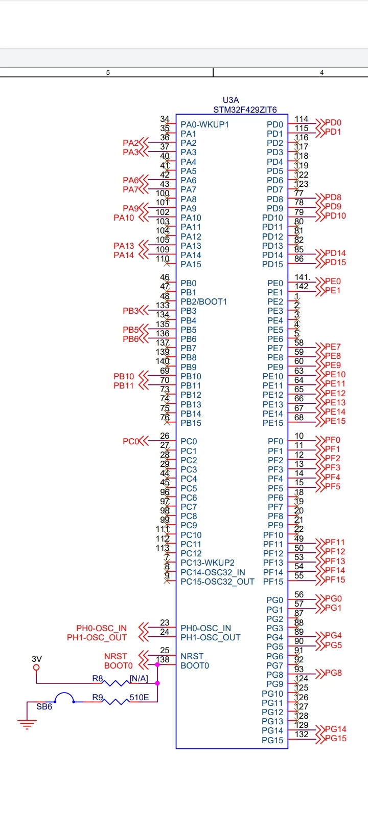

I'm want to send a string from one stm32 to another stm32 to blink an led on it I'm using uart polling method to do that.
The communication happens and led blinks only if I press the Reset button once I switch off and on power supply. What should be done if I want continuous communication.

Still lacking detail - that shows us nothing other than BOOT0 is connected to ground.
How about posting the code you have?

is this a custom board? BOOT0 pulled Low?
Try to provide some more detail rather than symptom.
harry123Author
Jan 25, 2024 1:25 PM UTC
Yes it's a custom board and. Boot0 is pulled low.

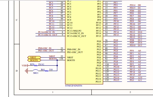

So there must be something wrong with the reset arrangements in your hardware
I have shorted SB1 and R24 in the Reset section and SB21 is shorted to ground and left R59 open on the F429 controller side.

Made custom board same as stm32f4 disc1. Sorry, I was confused  R24 is connected to 100K but it shows not fit in the schematic.
