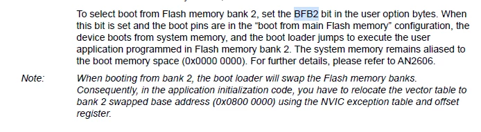

kaspars.laizans
November 12, 2021
Hi.
If memory serves me well, I ended up implementing without bootloader or runtime code swapping. I would receive new FW binary, check the current bank, write it to the other bank. Then toggle dual-bank bit in flash option bytes and reboot. Internal system bootloader then aliases either 0x0800000 (bank1) or 0x0810000 (bank2) to 0x00000000 (depending on dual bank enable bit) and continues from there. This allows for 2 things - no need to recompile for specific banks and system would also boot into previous bank, if new firmware gets corrupted (system bootloader checks for at least vector table in the bank before booting).
There were issues with the fact, that for R/W access banks are mapped correctly, but for erasing you need to figure out correct sectors, since those either remain as-is (for 2MB devices) or get remapped in weird ways (1MB devices).
Another 2 very important notes:
  1. Do firmware checks before and after flashing (I used inbuilt CRC32 peripheral). Sometimes you might get some bitflips which mess things up
  2. Be very very careful with what you write to flash in general and option bytes in particular. One of my devboards had protection lvl3 set for some reason and I couldn't clear it in any way I tried. Considered it bricked.

I was hoping that swapping banks in the initialisation code (SYSCFG_MEMRMP_UFB_MODE) means I don't need to worry about which bank I'm erasing. I'll always presume I'm running from 0x08000000 and writing new firmware to 0x08100000. Maybe this assumption is wrong but not too hard to get round if I know whether the bank is swapped or not.
I didn't want to use the BFB bit as started to get messy in my earlier testing, the manual was somewhat vague about it all and looks like you still need to remap the vector table anyway...
