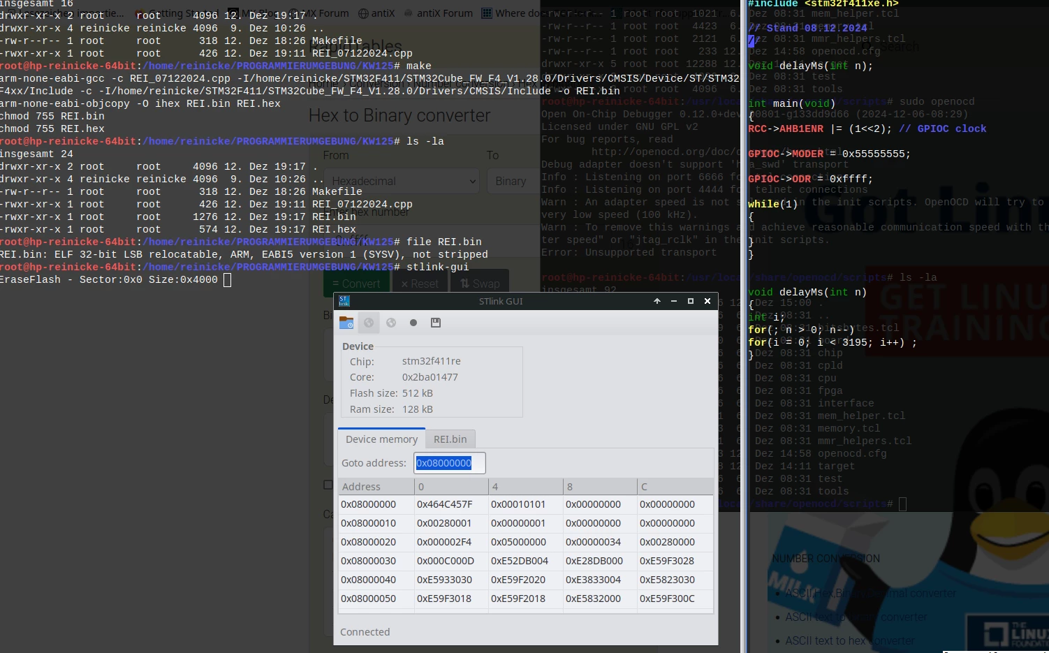

STM32F411CEU6 via STLINK V2 - C13 (Board LED: on/off) - configuration check under Linux with stlink-gui failed
Hi there,
follow the attached picture, an easy question for you, for me an effort.
left side:
Compiling procedure for a simple 32-bit binary file, ARM
right side:
program code - board LED should turn on
result:
turn on LED - failed
Questions:
A
In my opinion it is a failure regarding the "header-handling".
I work with the present CMSIS-files.
Are there hints to integrate the header in a right way?
Are there program failures?
B
Do you know an exactly openocd-instruction to reach the same result as with stlink-gui?
Regards,
timbo2023

Hello @timbo2023
Which compiler you are using please?
I recommend using the STM32Cube programmer to flash your MCU.
