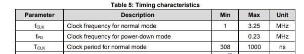

I've spend quite amount of time on that, and after borrowing logic analyzer, I found that, microphone do not output any data - looks like clock is too low. Audio_playback_and_record example uses 16Khz audio sampling, when I increase it to 48Khz  by changing below line:
#define DEFAULT_AUDIO_IN_FREQ I2S_AUDIOFREQ_48K
It kinda start working, there is finally some sound being recorded but there is also a lot of glitch there.

I have no experience with pdm mics, but from ds MP45DT02 :
( with 2ch - stereo , i assume )
at 16kHz *16b -> 256 khz (close to power down for the mics = zero output)
With PDM (= 1 bit modulation) you need hi speed data , decimate, then get good resolution.
The more data bits, the better the pcm signal.
From example here:
https://github.com/STMicroelectronics/x-cube-azrtos-f4/blob/befedcdd72388c9c9305eccf5208a19845c31b47/Drivers/BSP/STM32F411E-Discovery/stm32f411e_discovery_audio.c#L1048
see : decimation is 64, so with 16bit frames need 4x frame rate for desired sampling rate,
-> for 48kHz pcm audio need 192kHz input rate , giving 192k * 16 = 3,072 Mbit (close to max. frequ. for mic).
So look at your program and what bit rates you give to the PDMDecoder , deciding what quality you can expect.
