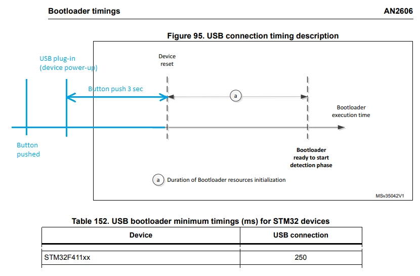

d.borodaenko
June 8, 2021
I found bootloader timing description in AN2606 but it is about minimum timing for bootloader initialization. In my case I have delay before device reset and bootloader init.0693W00000BaMqZQAV.png
Pavel A.
June 8, 2021
According to this, the device (DFU or normal firmware) must enumerate within ~ 1.5 s. after the host detects attachment on the USB port.
"the hub driver will attempt to retry enumeration up to 3 times by returning to the beginning of the “First Port Reset�? state.
A delay of 500ms occurs between each retry to allow the device to settle.
If the port reset times out on the 3rd retry, enumeration will be cancelled and an “Unknown Device�? will be reported".
So, do not let the host detect attachment until you're ready to enumerate.
-- pa
