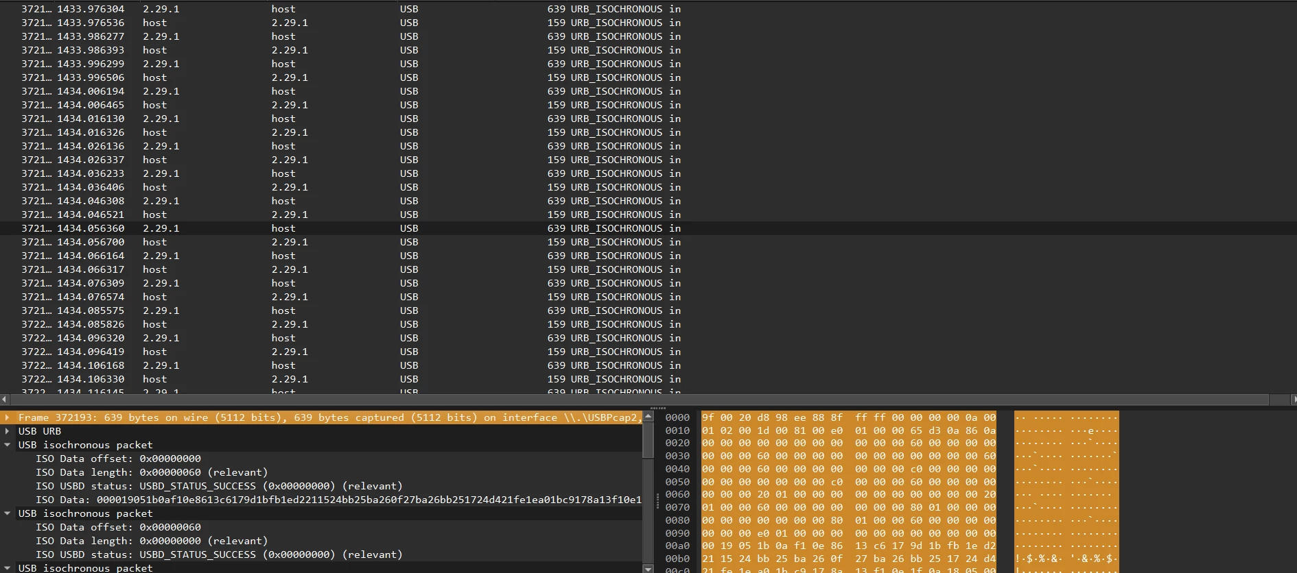

WireShark result:

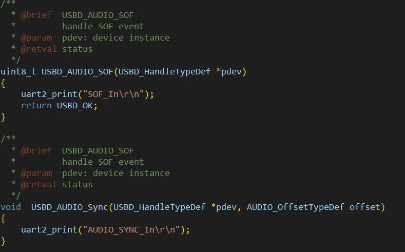

I tried marking all USBD_ClassTypeDef methods as serial output, like this:
Through the serial port output, I found that when the host sends the URB_ISOCHRONOUS IN request, although the MCU does not enter the USBD_AUDIO_DataIn function, it will enter the USBD_AUDIO_IsoINIncomplete function. After I added the function of sending data to the FIFO, the USB host can receive the data smoothly:

WireShark:
I hope to give some inspiration to other confused people. Thank you to everyone who is watching this post.

WireShark:
