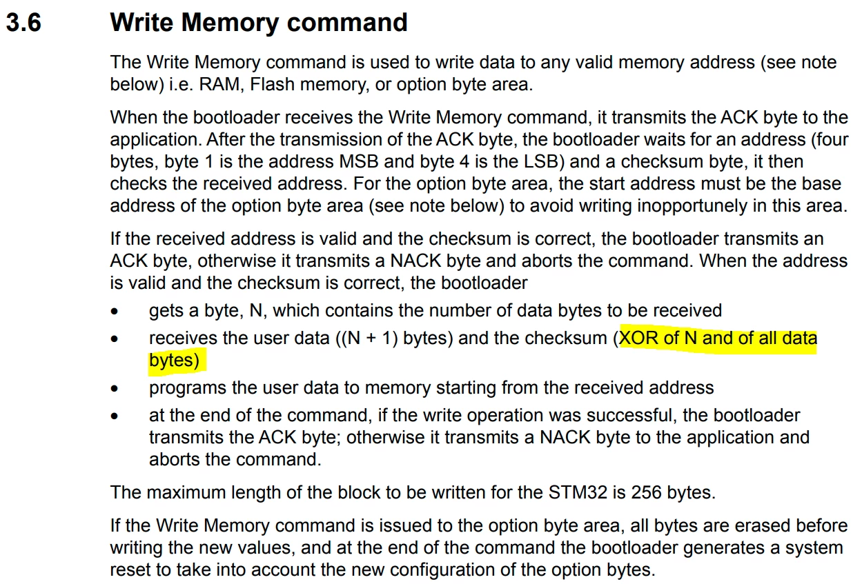

I'm trying to utilise the built-in UART bootloader in the STM32F410RB to perform firmware update. I've read the AN3155 and AN2606 documentation but unfortunately, I'm out of luck so far when trying to write the firmware via the bootloader to the target MCU's internal flash.

The following is not working for me:
  1. I send the "write memory" command and checksum, e.g. 0x31, 0xCE
  2. I receive the ACK, e.g. 0x79
  3. I send the 4 byte start address and checksum, e.g. 0x08, 0x00, 0x00, 0x00, 0x08
  4. I receive the ACK e.g 0x79
  5. I send no of four byte e.g 0x03
  6. I send data e.g 0x01 0x02 0x03 0x04
  7. I send check sum byte e.g :- 0x0D
  8. I receive the NACK e.g :- 0x1F
  9.
  10. I expected to receive an ACK response from the bootloader.
And I not write four byte to flash
so please help me to how to give sequence of command to bootloader so I can successfully write flash.
0x0D isn't the correct checksum here.
The correct checksum is 0x07 (0x03 ^ 0x01 ^ 0x02 ^ 0x03 ^ 0x04)

Nov 16, 2021 4:22 AM UTC
ok i try that way this is work.
