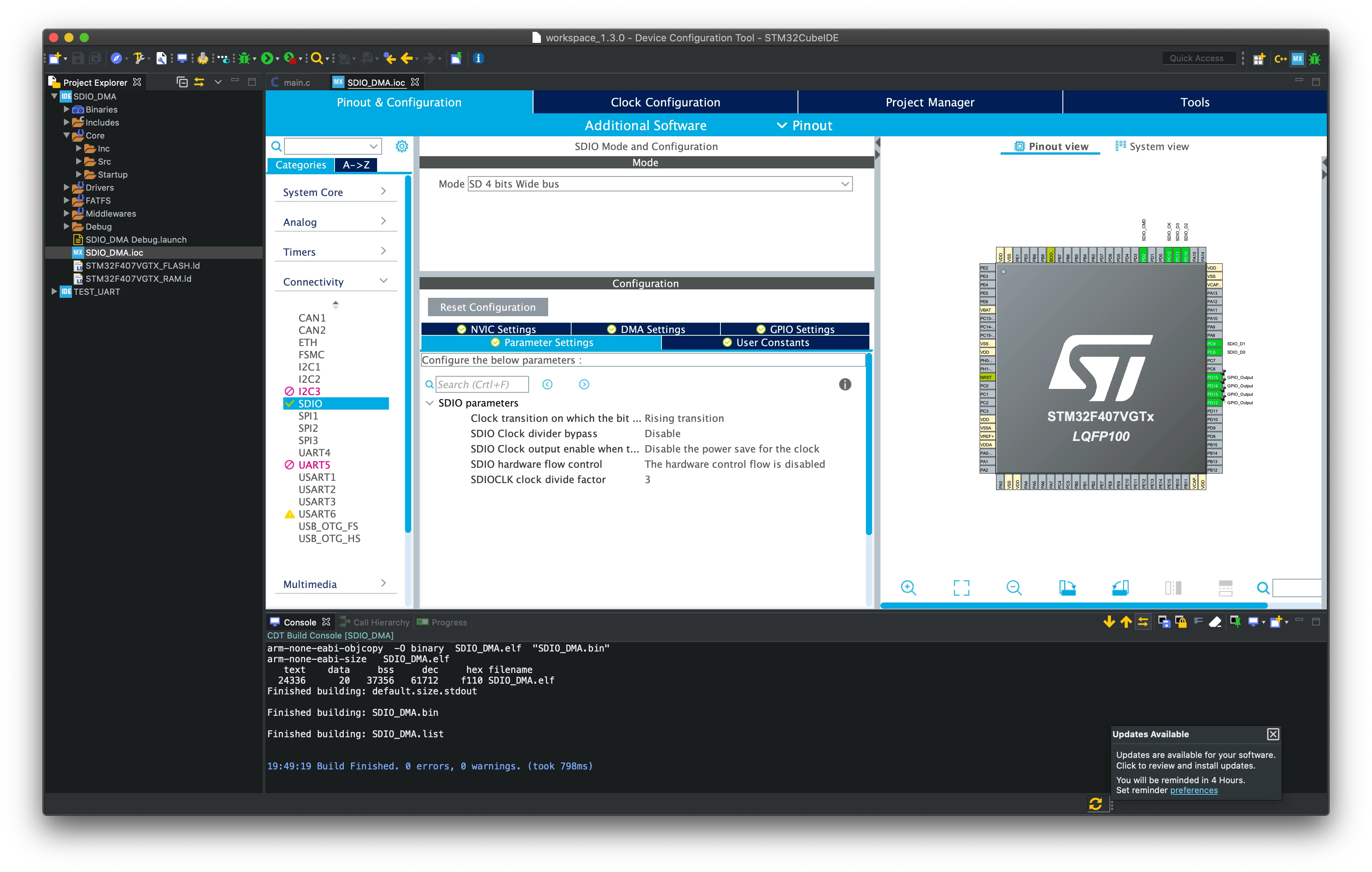

Hi everyone,
Sorry for this “Error while parsing Rich Text Content�?, I got an error when publishing. I can't share the whole file.
Problem :
> Even the card is present or not, The SD card is mounted .
> I can’t write a file to the sd card.
Context :
I read a lot of books, documentations and tutorials, I can’t find a way to make it work.
From the STM IDE debugger, I can’t get rich errors as I find with Python or Javascript. This is why I’m asking help. Except with printf but this is only a personal comment to my terminal. What I mean it's... I cannot I have a feedback from a function error. I only can track variable value. I spend a lot of time on it but I cannot solve this basic issue.

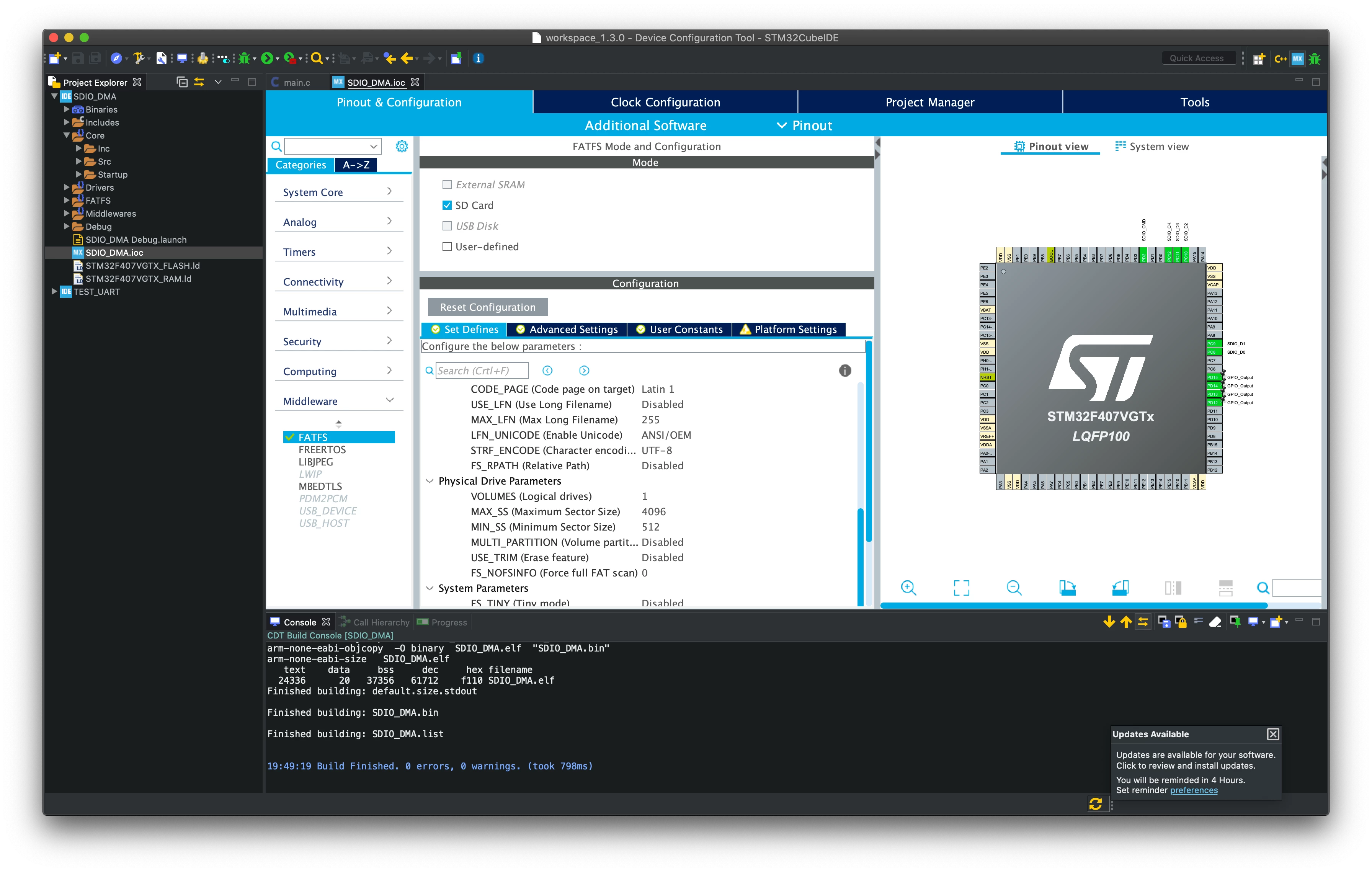

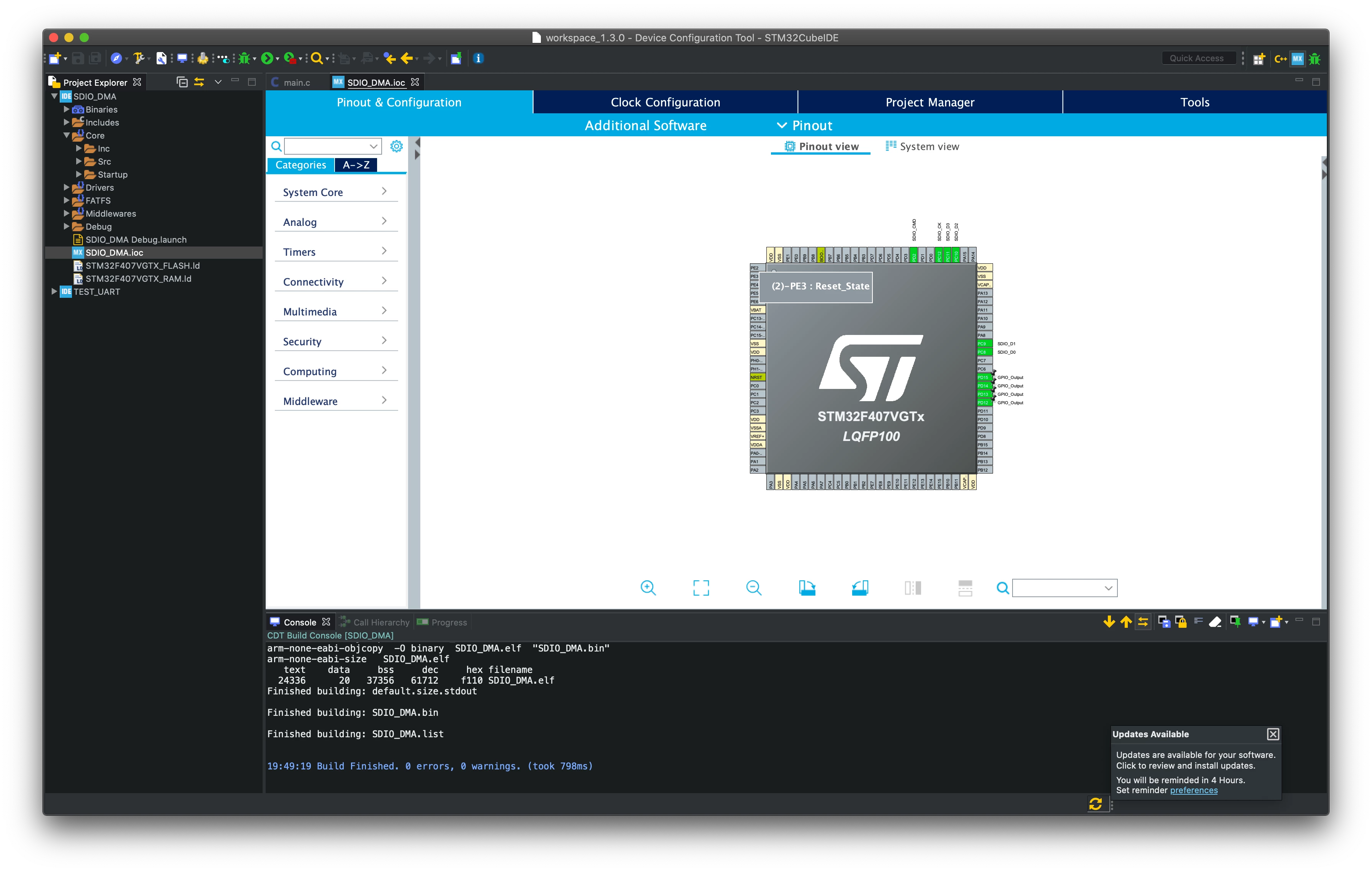

Cube MX set-up :
1 - pin
2 - FATFS configuration :
Only Physical drive were changed.
3 - SDIO set-up :
Please ask if you need more insight.
