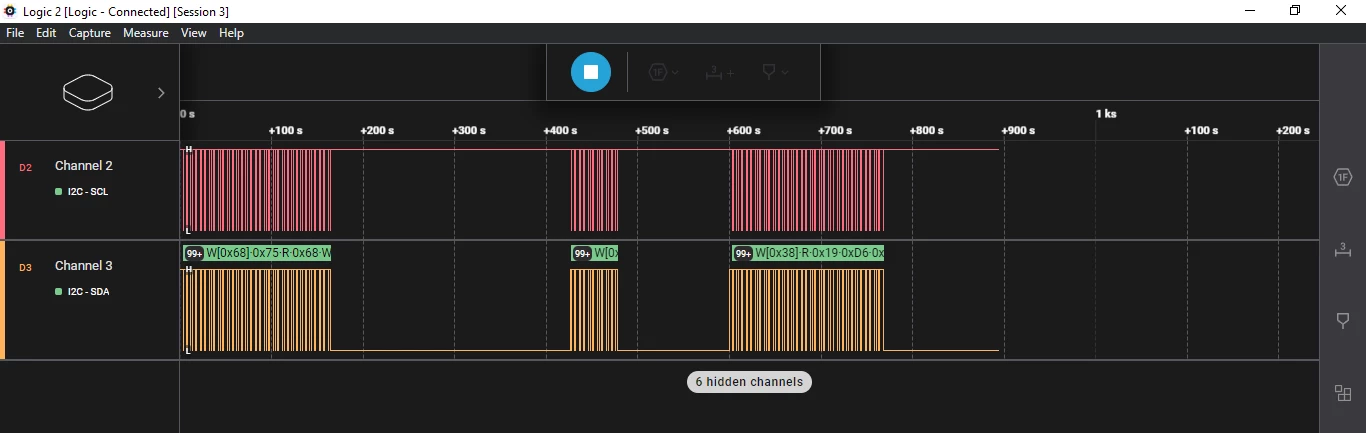

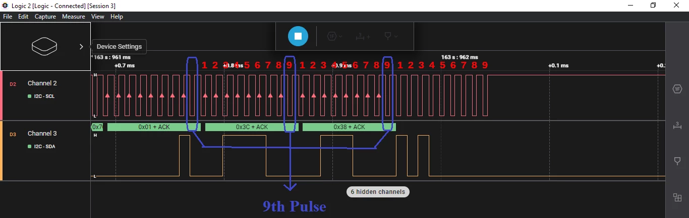

I have an STM32F407 (Master) communicating with an AHT10 device (Slave) over I2C as one to one. Till this part everything works just fine, the problem start when i add a new device (Slave) in the same bus (eg. MPU6050) after a while the I2C lines locked up (SCL High and SDA Low). As shown in the picture below.
Once I power off only the AHT10 Device the lines goes back normal, and if I put it back in the bus, after some times (the period of time it's not synchronised) the problem will appear again. As shown below.

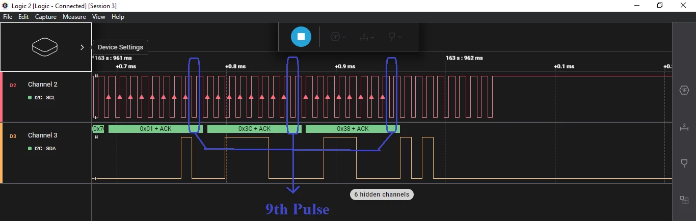

At first i thought that the problem within the AHT10 Device and As I mentioned before in one to one connectivity he works just fine. Even tho, the master his the one that he should release the line. Aside from that, I noticed that the I2C not sending the 9th clock pulse to release the I2C lines. As shown below.

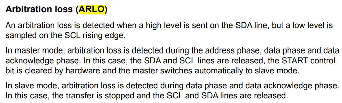

So, I checked the I2C_ISR register to get the status of the I2C peripheral and I found that the ARLO Bit = 1 (Arbitration Lost Bit), so I tried to reset the I2C through the SWRST Bit (Software Reset) in the I2C_CR1 register. After, the I2C is initialized and the register statue returned to the ideal state, but the problem remain the same.

waclawek.jan
Feb 23, 2024 9:37 AM UTC
Yes, it is - it "understands" some of the commands to the other device as commands directed to it, and responds to it. Are the I2C addresses of both devices different?
ARLO=1 means "some other device pulled SDA low while I, the master, have set it to 1".
I don't understand the remark about the 9th pulse.
- The 9th pulse suppose to release the bus ( and correct me if am wrong ).

waclawek.jan
Feb 23, 2024 1:40 PM UTC
You can check, which device pulls down SDA, by inserting small (roughly 1/10-1/5 value of the pullup) resistors in series (two different values for the two slaves) - this arrangement should result in different voltages on SDA (but still below the logic-0 threshold), as the series resistors form a voltage divider together with the pullup; and measuring that voltage in the case of error would reveal, which device pulls down SDA.
Yes, but only when the offending device is in sync. It may quite well not be, given this is an unexpected behaviour anyway.
Feb 23, 2024 2:20 PM UTC
ARLO getting set is indicative of a badly behaving slave device. The STM32 releases SDA and SCL in such an instance. Probably this is happening on the 8th bit, so the STM32 releases the lines and doesn't try the ACK bit.
Perhaps the AHT10 is pulling down SDA too early.
An analog capture might be more informative here.

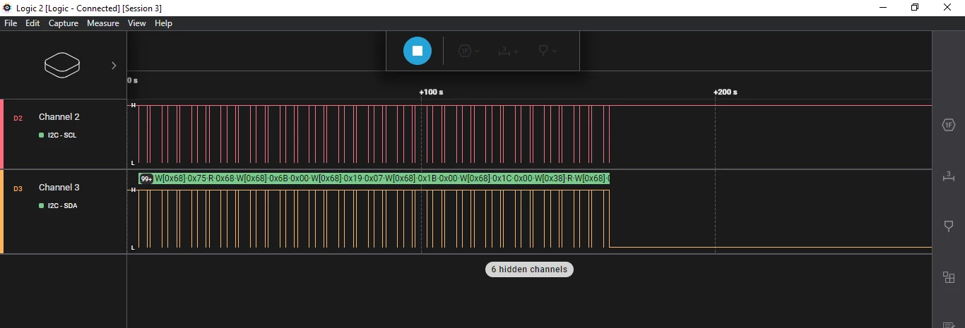

Feb 23, 2024 10:03 PM UTC
Maybe. There are writes to both 0x38 and 0x68 in that chain of actions. Don't think the address of the device is shown for the zoomed in screenshot that you annotated, only the last 3-4 bytes. The 0x38 shown there is data, not an address.
The idle case (SDA+SCL both high) isn't shown anywhere at all. Start condition not shown anywhere. The device is probably out of sync from the outset.
Perhaps missing pullups, or initialization is done in a sloppy manner.
- Yes there are, and they are separated with some of time (2s, 3s, 4s) in the software.
- Yes there is, the idle status it's more clear at the beginning in the first picture.

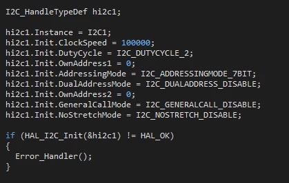

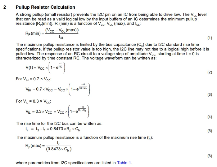

- Am already using pull-up resistors and calculated as shown below plus my I2C config

waclawek.jan
Feb 24, 2024 9:39 AM UTC
@TDK, fair points.
Indeed. But... what if AHT10 considers it as an address? It's a chinese product, after all, and I've seen I2C devices deviant in various ways even from reputable manufacturers during the years.
@Mr_RO, show us a zoomed section of the end of communication, so that at the beginning of that zoomed section both SDA and SCL are high, then we see START, and then all the rest of communication ending with the invalid SDA being low state. It may take more than one screenful, but that does not matter.

Mr_ROAuthor
Feb 25, 2024 4:17 PM UTC
Hi waclawek.jan
- Maybe that's the case, I didn't' noticed till now but I will follow each last msg or add before the SDA goes low.
- Okay I will try.
