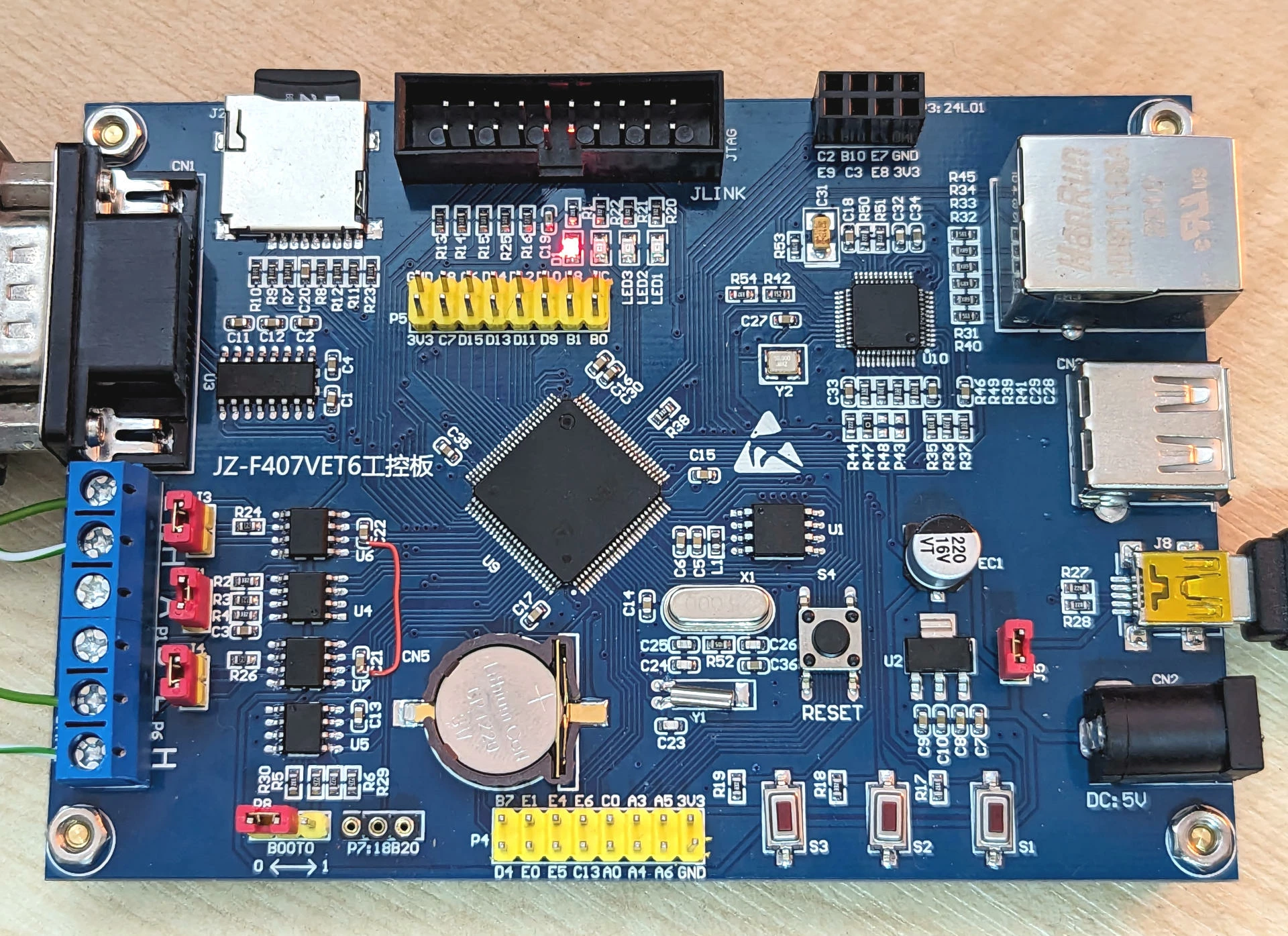

I have the following Board with an STM32F407VET:
I started from a github repo with a working configuration:
https://github.com/art103/JZ-F407VET6
I removed everything I don't need in my .ioc file, created the code and added the following files to the while()-loop in the main function:

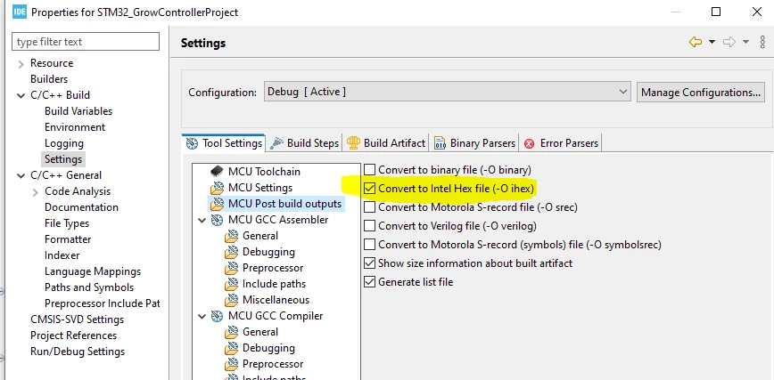

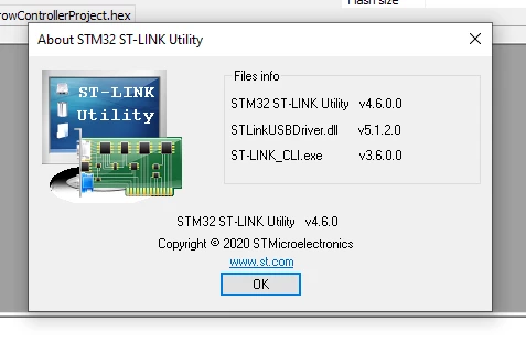

Maybe I should add that I'm unable to flash via STM32CubeIDE with my ST-Link V2 "CN edition".
So i'm creating the .hex file and flash it via the STM32 ST-Link Utility
mƎALLEm
May 13, 2024 4:18 PM UTC
I've ported your project to STM32F4-Discovery board and I didn't reproduce the issue.
The LEDs (three LEDs) are toggling well in StartDefaultTask().
I'm attaching the project (I just introduced a modification on PD12 to PD15 gpio pins to be as outputs for LEDs + Clock config to adapt it to the disco board).
PS: ST-Link Utility is a deprecated tool and no more supported. Use STM32CubeProgrammer instead.
Visitor II
Jun 23, 2024 6:00 PM UTC
Hello, I am having trouble finding the Datasheet of the exact development board based on (STM32F407VET6) you are using, Could you share where you got your datasheet.
splasherAuthor
Jun 24, 2024 6:21 PM UTC
There is one pull request where the pdf is attached.
That's everything I found
