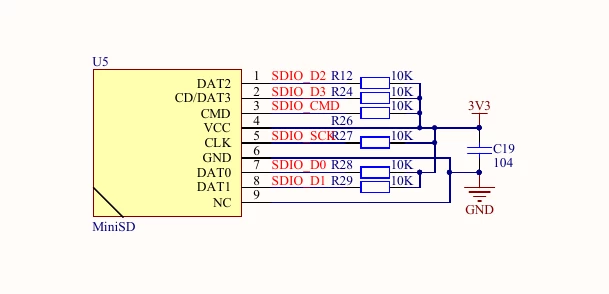

I am using STM32F407VE Black Board. It contains the STM32F407VET6 chip. It has a microSD slot but the slot's CD pin is not connected. Due to this f_mount() is always returning faults. I don't know if this hardware miss connection is the primary problem why f_mount() returns faults or there are more problems. Please help me out with this. I am stuck since 2-3 days. I tried modifying the dist_status and dist_initialize functions to bypass this hardware check but when I upload the code, the board does nothing for 20-30sec and f_mount again returns error. I have attached my code changes

What is the "slot's CD pin " ?   micro SD , see ->
...and this is connection on F407VET black board :
June 18, 2025
When you use it in 4B mode, CD is being utilized as DAT3 which leaves no other pin for selecting the chip

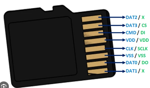

Ok, now i see: you puzzle the 2 possible interfaces : SPI (with CD/CS ) vs. SDIO (no CD, but 4 data lines) .
See in pic of card i posted: green(SPI) or blue names for interface on card.
So on using SDIO/SDMMC interface , as its here, there IS NO CD line !
And SD-card always starting in 1-bit mode (= standard) , for 4-bit its - after communication SDMMC --- SDcard is working - then switched to other mode (speed setting, 4bit, voltage ...).
